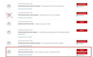

  • Greetings Jesse,
    Readme:
    2) Download the latest MCU+SDK from the board product page (www.ti.com/.../SK-AM62A-LP)
    My result (seems OK):
    i downloaded sdk+mcu (ti-processor-sdk-linux-am62xxsip-evm-10.00.07.04-Linux-x86-Install.bin
    This is not the MCU+SDK, it appears you installed the Linux SDK. The MCU+ SDK can be found in the software page, highlighted the distinction below:
    To save some trouble, here is a direct link to the MCU+SDK for AM62X: https://www.ti.com/tool/download/MCU-PLUS-SDK-AM62X
    Sincerely,
    Lucas
