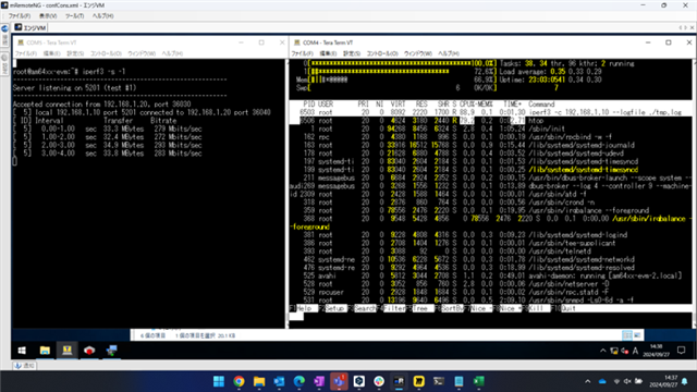

The PRP throughput was measured by connecting two SK-AM64Bs in opposition to each other.
The measured throughput for client-server communication of iperf was approximately 300Mbps.
-The two Ethernet ports on the board are connected to the ports of the communication partner without an L2SW in between.
-The PRP stack implemented in the Linux driver was used in NON-offload mode for PRP.
The SDK used was 09.02.01.09 (29 Mar 2024).
-In a normal single-cable connection without PRP, the throughput is over 800Mbps.
So here are my questions.Please answer as much as possible.
Is the PRP throughput of 300Mbps for the SK-AM64B reasonable?
1)Is there an error in the way I'm using the PRP?
Is the interface speed supported by the PRP correct at 1Gbps? Or is it 100Mbps?
Does the PRP in the SDK I used implement the IEC 62439-3 Edition 3 standard?
2)How can I increase the throughput?
If I use two PC-Linux instead of SK-AM64B, the throughput of PRP is 1Gbps.
Will updating to the latest SDK 10.00.07.04 (14 Aug 2024) improve it?
Are there any tuning items?
3)Is this the limit of performance in non-offload mode?
When will the PRP offload modules (firmware) for PRU-ICSSG and CPSW3g be completed?

    I am using iperf3.
    The only processes or kernel processing running after Linux starts up are iperf3 and PRP communication.
    Before starting iperf3, the A53 load is only 2-3%, but while iperf3 is running it reaches its limit of about 90%.
    The method you advised gives priority to iperf3 and related processes over other processes,
    so I don't think it will be very effective if there are almost no other processes.
    One way to increase the PRP throughput would be to make the PRP parallel processing so that both A53 cores on the AM6442 can be fully used.
    Is this possible?
    Without using PRP, the iperf3 throughput is 800Mbps, but the CPU load at that time reaches its limit of about 90%.

    Thank you for your patience. I was able to see similar results of ~300Mbps throughput rate when PRP was setup on two AM64x EVMs (for me this was on the TMDS64EVMs) on the CPSW ethernet interfaces.
    Topology:
    TMDS64EVM1 eth0 <> TMDS64EVM2 eth0
    TMDS64EVM1 eth1 <> TMDS64EVM2 eth1
    SDK Version:
    RT-Linux 10.00.07
    Test Sequence:
    1. Run sh ./prp_setup.sh prp eth0 eth1 192.168.1.10 on EVM1 where prp_setup.sh is from the script in https://software-dl.ti.com/processor-sdk-linux/esd/AM64X/10_00_07_04/exports/docs/linux/Foundational_Components/Kernel/Kernel_Drivers/Network/HSR_PRP_Non_Offload.html?highlight=prp
    2. Run sh ./prp_setup.sh prp eth0 eth1 192.168.1.20 on EVM2
    3. Ping from EVM1 to EVM2 and disconnect one cable path --> no discontinuation of communication
    4. Setup iperf3 server on EVM2 and iperf3 client on EVM1 using TCP communication and I see the below result. What is concerning is that there are retries occuring for every transfer, which is indicating that many packets are being dropped. This in turn could be influencing the throughput rate, resulting in a lower than expected rate.

    Some additional actions I tried was
    1. Changing the iperf3 priority to 60 and scheduling policy from Round Robin to FIFO --> increased throughput slightly to ~450Mbps
    2. Changing ksoftirq0 and ksoftirq1 priority to 70 and scheduling policy from Time Slice to FIFO --> did not result in any noticeable changes to throughput
    In my measurements, I observed packet drops, but they occurred infrequently, so I believe the impact on throughput is small.

    3. Why do you think your throughput was improved by the above changes?
    The FIFO scheduling policy is known to be a "real-time" policy that will always immediately preempt any currently running SCHED_OTHER, SCHED_BATCH or SCHED_IDLE processes. Theoretically, changing to FIFO should help prevent other processes in the background from preempting the iperf3 process.
    However, theoretically, the main improvement in throughput should be from the priority (higher the priority, the better the throughput is the theoretical behavior).
    I noticed that comparing the below three, #3 has a much better load for the iperf3 process. However, what is weird is that I wasn't able to see the throughput improvement that I saw from last week.
    1. Baseline CPSW (no PRP) CPU Load = ~35.8%
    2. Baseline PRP CPU Load = ~77.2%
    3. FIFO priority 85 CPU load = ~17.6%

    4. Baseline CPSW CPU load
    0[####************************************************************ 66.9%] Tasks: 34, 16 thr, 119 kthr; 0 running
    1[********************************************************************************* 86.0%] Load average: 1.38 0.70 0.28
    Mem[||||||#@$$$$$$$$$$ 114M/1.78G] Uptime: 00:02:52
    Swp[ 0K/0K]
    [Main] [I/O]
    Please tell me the procedure for measuring CPU load with iperf3 in your environment.
    What Linux command is used to execute the above output?

    3. Run htop to view the CPU load. This Linux utility tool should already be included in the filesystem from the SDK and can be used to view information about all processes that are currently running live. Information about htop: https://htop.dev/
    4. Compare the CPU load from htop to the case of PRP not being setup (Baseline CPSW) and the case of iperf3 without the elevated priority (Baseline PRP)
    The CPU load rates of iperf3 you measured above are all lower than ours, and the CPU is under load.
    In this case, where do you think the bottleneck in iperf3/PRP throughput is?
    According to our measurements using vmstat, the CPU load is over 90% when the throughput of iperf3/PRP is 300Mbps.
    Based on these results, we believe that the throughput bottleneck is in the CPU processing capacity.
    Could you show the result of running htop (show the entire output as a snapshot). I'm wondering if there might be some other processes you might have running in the background that resulted in the higher CPU load you reported.

  • What I'm currently trying to understand is the relationship between the throughput and the CPU load.
    We hope that both of your iperf3/PRP measurement results will be the same as ours.
    Your communication throughput measurement result was about 300Mbps, so there is no problem.
    On the other hand, your CPU usage measurement result differs from ours. We believe that the cause is the difference in measurement method.
    We also tried the htop command that you used.
    The output screen of this command has a problem where it updates with some delay when the CPU load is high, so we determined that this command does not display CPU usage correctly.
    Therefore, we recommend that you use the same vmstat/mpstat as we did to measure CPU usage accurately.
    While vmstat outputs the average CPU usage per core, mpstat also outputs the CPU usage per core in addition to that.
    Therefore, we would like you to measure CPU usage using mpstat as follows.
    - mpstat -P ALL 1
    We would also like you to at least measure the CPU usage of the data receiving side, i.e. the server machine.
    The reason for this is that, according to our measurements, the CPU load of the server machine reaches its upper limit before that of the client machine.
    (The server machine's CPU usage reaches 90% or more.)
    The server machine's receiving process is the bottleneck for communication throughput.
    The same phenomenon was observed when measuring iperf3 throughput without using PRP.
    We apologize for the inconvenience, but please make sure that the same phenomenon can be observed in your environment.
    Specifically, we would like you to measure the following two types of CPU usage on the server machine in your environment. The increase of the two CPU usage rates will be the CPU usage for iperf3/prp.
    1. Measure the CPU usage before running iperf3/PRP.
      If CPU usage is more than 2-3%, check whether any processes that are not necessary for the measurement are running.
      If it is high, stop the unnecessary processes.
    2. Measure the CPU usage while iperf3/PRP is running.
      You should be able to confirm that CPU usage is at or above 90%, the same as ours.

    TMDS64EVM2 CPU load --> ~1% load
    root@am64xx-evm:~# uname -a
    Linux am64xx-evm 6.6.32-rt32-ti-rt-g04a9ad081f0f-dirty #1 SMP PREEMPT_RT Fri Jul 26 14:42:37 UTC 202x
    root@am64xx-evm:~# mpstat -P ALL 1
    Linux 6.6.32-rt32-ti-rt-g04a9ad081f0f-dirty (am64xx-evm)        03/02/24        _aarch64_       (2 C)
    No PRP, baseline iperf3 setup:
    Both eth0 and eth1 connected and running iperf3
    TMDS64EVM1 CPU load (iperf3 client) --> greater 90% load
    root@am64xx-evm:~# iperf3 -c 192.168.3.20 -t0 > /dev/null &
    [1] 1084
    root@am64xx-evm:~# iperf3 -c 192.168.2.20 -t0 > /dev/null &
    [2] 1093

    TMDS64EVM2 CPU load (iperf3 server) --> greater 90% load
    root@am64xx-evm:~# iperf3 -s -B 192.168.2.20 > /dev/null &
    [1] 1055
    root@am64xx-evm:~# iperf3 -s -B 192.168.3.20 > /dev/null &
    [2] 1056
    root@am64xx-evm:~# iperf3: the client has terminated
    05:56:38     CPU    %usr   %nice    %sys %iowait    %irq   %soft  %steal  %guest   %idle
    05:56:39     all    2.51    0.00   48.24    0.00    0.00   45.73    0.00    0.00    3.52
    05:56:39       0    5.00    0.00   88.00    0.00    0.00    4.00    0.00    0.00    3.00
    05:56:39       1    0.00    0.00    7.14    0.00    0.00   87.76    0.00    0.00    5.10
    05:56:39     CPU    %usr   %nice    %sys %iowait    %irq   %soft  %steal  %guest   %idle
    05:56:40     all    2.03    0.00   47.21    0.00    0.00   47.72    0.00    0.00    3.05
    05:56:40       0    3.06    0.00   88.78    0.00    0.00    6.12    0.00    0.00    2.04
    05:56:40       1    0.00    0.00    7.00    0.00    0.00   89.00    0.00    0.00    4.00
    05:56:40     CPU    %usr   %nice    %sys %iowait    %irq   %soft  %steal  %guest   %idle
    05:56:41     all    2.53    0.00   48.48    0.00    0.00   46.46    0.00    0.00    2.53
    05:56:41       0    5.00    0.00   88.00    0.00    0.00    5.00    0.00    0.00    2.00
    05:56:41       1    0.00    0.00    8.16    0.00    0.00   88.78    0.00    0.00    3.06
    05:56:41     CPU    %usr   %nice    %sys %iowait    %irq   %soft  %steal  %guest   %idle
    05:56:42     all    1.00    0.00   48.50    0.00    0.00   48.00    0.00    0.00    2.50
    05:56:42       0    2.02    0.00   90.91    0.00    0.00    5.05    0.00    0.00    2.02
    05:56:42       1    1.00    0.00    7.00    0.00    0.00   90.00    0.00    0.00    2.00
    05:56:42     CPU    %usr   %nice    %sys %iowait    %irq   %soft  %steal  %guest   %idle
    05:56:43     all    3.02    0.00   49.25    0.00    0.00   46.23    0.00    0.00    1.51
    05:56:43       0    6.00    0.00   87.00    0.00    0.00    5.00    0.00    0.00    2.00
    05:56:43       1    0.00    0.00   11.11    0.00    0.00   87.88    0.00    0.00    1.01
    05:56:43     CPU    %usr   %nice    %sys %iowait    %irq   %soft  %steal  %guest   %idle
    05:56:44     all    1.01    0.00   46.73    0.00    0.00   46.23    0.00    0.00    6.03
    05:56:44       0    1.01    0.00   84.85    0.00    0.00    7.07    0.00    0.00    7.07
    05:56:44       1    0.00    0.00    9.00    0.00    0.00   85.00    0.00    0.00    6.00
    05:56:44     CPU    %usr   %nice    %sys %iowait    %irq   %soft  %steal  %guest   %idle
    05:56:45     all    4.02    0.00   49.25    0.00    0.00   44.22    0.00    0.00    2.51
    05:56:45       0    7.00    0.00   85.00    0.00    0.00    5.00    0.00    0.00    3.00
    05:56:45       1    2.00    0.00   13.00    0.00    0.00   84.00    0.00    0.00    1.00
    05:56:45     CPU    %usr   %nice    %sys %iowait    %irq   %soft  %steal  %guest   %idle
    05:56:46     all    1.54    0.00   47.69    0.00    0.00   47.18    0.00    0.00    3.59
    05:56:46       0    3.03    0.00   89.90    0.00    0.00    5.05    0.00    0.00    2.02
    05:56:46       1    0.00    0.00    4.12    0.00    0.00   89.69    0.00    0.00    6.19
    05:56:46     CPU    %usr   %nice    %sys %iowait    %irq   %soft  %steal  %guest   %idle
    05:56:47     all    2.54    0.00   49.24    0.00    0.00   44.16    0.00    0.00    4.06
    05:56:47       0    5.00    0.00   88.00    0.00    0.00    4.00    0.00    0.00    3.00
    05:56:47       1    0.00    0.00    8.33    0.00    0.00   86.46    0.00    0.00    5.21
    05:56:47     CPU    %usr   %nice    %sys %iowait    %irq   %soft  %steal  %guest   %idle
    05:56:48     all    2.00    0.00   49.00    0.00    0.00   47.50    0.00    0.00    1.50
    05:56:48       0    3.06    0.00   90.82    0.00    0.00    5.10    0.00    0.00    1.02
    05:56:48       1    0.00    0.00    9.00    0.00    0.00   90.00    0.00    0.00    1.00
    05:56:48     CPU    %usr   %nice    %sys %iowait    %irq   %soft  %steal  %guest   %idle
    05:56:49     all    2.02    0.00   50.00    0.00    0.00   46.46    0.00    0.00    1.52
    05:56:49       0    4.00    0.00   88.00    0.00    0.00    5.00    0.00    0.00    3.00
    05:56:49       1    0.00    0.00   12.12    0.00    0.00   86.87    0.00    0.00    1.01
    ^C
    root@am64xx-evm:~#
    TMDS64EVM1 CPU load (iperf3 client) --> ~70% load
    root@am64xx-evm:~# ifconfig prp0
    prp0: flags=4163<UP,BROADCAST,RUNNING,MULTICAST>  mtu 1494
            inet 192.168.1.10  netmask 255.255.255.0  broadcast 0.0.0.0
            inet6 fe80::3608:e1ff:fe80:a7ad  prefixlen 64  scopeid 0x20<link>
            ether 34:08:e1:80:a7:ad  txqueuelen 1000  (Ethernet)
            RX packets 67  bytes 9605 (9.3 KiB)
            RX errors 0  dropped 8  overruns 0  frame 0
            TX packets 48  bytes 5065 (4.9 KiB)
            TX errors 0  dropped 0 overruns 0  carrier 0  collisions 0
    root@am64xx-evm:~# iperf3 -c 192.168.1.20 -t0 > /dev/null &
    [1] 1065
    Linux 6.6.32-rt32-ti-rt-g04a9ad081f0f-dirty (am64xx-evm)        03/02/24        _aarch64_       (2 )
    05:28:20     CPU    %usr   %nice    %sys %iowait    %irq   %soft  %steal  %guest   %idle
    05:28:21     all    2.12    0.00   50.26    0.00    0.00   17.99    0.00    0.00   29.63
    05:28:21       0    3.30    0.00   36.26    0.00    0.00   23.08    0.00    0.00   37.36
    05:28:21       1    1.02    0.00   62.24    0.00    0.00   14.29    0.00    0.00   22.45
    05:28:21     CPU    %usr   %nice    %sys %iowait    %irq   %soft  %steal  %guest   %idle
    05:28:22     all    1.60    0.00   47.34    0.00    0.00   20.21    0.00    0.00   30.85
    05:28:22       0    2.20    0.00   34.07    0.00    0.00   24.18    0.00    0.00   39.56
    05:28:22       1    1.03    0.00   59.79    0.00    0.00   15.46    0.00    0.00   23.71
    05:28:22     CPU    %usr   %nice    %sys %iowait    %irq   %soft  %steal  %guest   %idle
    05:28:23     all    1.08    0.00   51.61    0.00    0.00   17.20    0.00    0.00   30.11
    05:28:23       0    2.22    0.00   40.00    0.00    0.00   23.33    0.00    0.00   34.44
    05:28:23       1    1.02    0.00   61.22    0.00    0.00   12.24    0.00    0.00   25.51
    05:28:23     CPU    %usr   %nice    %sys %iowait    %irq   %soft  %steal  %guest   %idle
    05:28:24     all    1.06    0.00   46.03    0.00    0.00   21.16    0.00    0.00   31.75
    05:28:24       0    2.17    0.00   33.70    0.00    0.00   27.17    0.00    0.00   36.96
    05:28:24       1    0.00    0.00   58.33    0.00    0.00   15.62    0.00    0.00   26.04
    05:28:24     CPU    %usr   %nice    %sys %iowait    %irq   %soft  %steal  %guest   %idle
    05:28:25     all    0.53    0.00   46.28    0.00    0.00   20.21    0.00    0.00   32.98
    05:28:25       0    0.00    0.00   37.36    0.00    0.00   24.18    0.00    0.00   38.46
    05:28:25       1    0.00    0.00   55.10    0.00    0.00   16.33    0.00    0.00   28.57
    05:28:25     CPU    %usr   %nice    %sys %iowait    %irq   %soft  %steal  %guest   %idle
    05:28:26     all    1.60    0.00   48.94    0.00    0.00   19.68    0.00    0.00   29.79
    05:28:26       0    3.30    0.00   38.46    0.00    0.00   24.18    0.00    0.00   34.07
    05:28:26       1    0.00    0.00   59.57    0.00    0.00   14.89    0.00    0.00   25.53
    05:28:26     CPU    %usr   %nice    %sys %iowait    %irq   %soft  %steal  %guest   %idle
    05:28:27     all    0.00    0.00   49.73    0.00    0.00   18.38    0.00    0.00   31.89
    05:28:27       0    0.00    0.00   33.71    0.00    0.00   23.60    0.00    0.00   42.70
    05:28:27       1    1.01    0.00   62.63    0.00    0.00   14.14    0.00    0.00   22.22
    05:28:27     CPU    %usr   %nice    %sys %iowait    %irq   %soft  %steal  %guest   %idle
    05:28:28     all    1.07    0.00   49.20    0.00    0.00   19.25    0.00    0.00   30.48
    05:28:28       0    1.10    0.00   38.46    0.00    0.00   25.27    0.00    0.00   35.16
    05:28:28       1    0.00    0.00   60.42    0.00    0.00   13.54    0.00    0.00   26.04
    05:28:28     CPU    %usr   %nice    %sys %iowait    %irq   %soft  %steal  %guest   %idle
    05:28:29     all    0.00    0.00   48.66    0.00    0.00   20.32    0.00    0.00   31.02
    05:28:29       0    1.10    0.00   28.57    1.10    0.00   28.57    0.00    0.00   40.66
    05:28:29       1    0.00    0.00   65.98    0.00    0.00   12.37    0.00    0.00   21.65
    05:28:29     CPU    %usr   %nice    %sys %iowait    %irq   %soft  %steal  %guest   %idle
    05:28:30     all    1.60    0.00   42.55    0.00    0.00   22.87    0.00    0.00   32.98
    05:28:30       0    3.30    0.00   35.16    0.00    0.00   25.27    0.00    0.00   36.26
    05:28:30       1    0.00    0.00   50.52    0.00    0.00   19.59    0.00    0.00   29.90
    05:28:30     CPU    %usr   %nice    %sys %iowait    %irq   %soft  %steal  %guest   %idle
    05:28:31     all    0.53    0.00   47.59    0.00    0.00   19.79    0.00    0.00   32.09
    05:28:31       0    0.00    0.00   32.95    0.00    0.00   26.14    0.00    0.00   40.91
    05:28:31       1    1.03    0.00   60.82    0.00    0.00   14.43    0.00    0.00   23.71
    05:28:31     CPU    %usr   %nice    %sys %iowait    %irq   %soft  %steal  %guest   %idle
    05:28:32     all    0.53    0.00   51.06    0.00    0.00   18.62    0.00    0.00   29.79
    05:28:32       0    0.00    0.00   34.44    0.00    0.00   24.44    0.00    0.00   41.11
    05:28:32       1    1.01    0.00   65.66    0.00    0.00   13.13    0.00    0.00   20.20
    05:28:32     CPU    %usr   %nice    %sys %iowait    %irq   %soft  %steal  %guest   %idle
    05:28:33     all    0.53    0.00   47.59    0.00    0.00   19.79    0.00    0.00   32.09
    05:28:33       0    0.00    0.00   33.33    0.00    0.00   26.67    0.00    0.00   40.00
    05:28:33       1    0.00    0.00   61.46    0.00    0.00   13.54    0.00    0.00   25.00
    05:28:33     CPU    %usr   %nice    %sys %iowait    %irq   %soft  %steal  %guest   %idle
    05:28:34     all    4.79    0.00   51.06    0.00    0.00   18.09    0.00    0.00   26.06
    05:28:34       0    6.52    0.00   41.30    0.00    0.00   21.74    0.00    0.00   30.43
    05:28:34       1    3.06    0.00   60.20    0.00    0.00   15.31    0.00    0.00   21.43
    05:28:34     CPU    %usr   %nice    %sys %iowait    %irq   %soft  %steal  %guest   %idle
    05:28:35     all    0.54    0.00   49.73    0.54    0.00   17.84    0.00    0.00   31.35
    05:28:35       0    1.15    0.00   31.03    0.00    0.00   25.29    0.00    0.00   42.53
    05:28:35       1    1.02    0.00   66.33    0.00    0.00   11.22    0.00    0.00   21.43
    05:28:35     CPU    %usr   %nice    %sys %iowait    %irq   %soft  %steal  %guest   %idle
    05:28:36     all    1.06    0.00   48.40    0.00    0.00   19.68    0.00    0.00   30.85
    05:28:36       0    1.12    0.00   43.82    0.00    0.00   21.35    0.00    0.00   33.71
    05:28:36       1    0.00    0.00   54.17    0.00    0.00   17.71    0.00    0.00   28.12
    ^C
    root@am64xx-evm:~#
    TMDS64EVM2 CPU load (iperf3 server) --> ~85% load
            inet 192.168.1.20  netmask 255.255.255.0  broadcast 0.0.0.0
            inet6 fe80::1e63:49ff:fe1a:d8aa  prefixlen 64  scopeid 0x20<link>
            ether 1c:63:49:1a:d8:aa  txqueuelen 1000  (Ethernet)
            RX packets 17  bytes 3088 (3.0 KiB)
            RX errors 0  dropped 26  overruns 0  frame 0
            TX packets 51  bytes 5456 (5.3 KiB)
    root@am64xx-evm:~# iperf3 -s > /dev/null &
    [1] 1050
    05:17:06     CPU    %usr   %nice    %sys %iowait    %irq   %soft  %steal  %guest   %idle
    05:17:07     all    1.08    0.00   26.34    0.00    0.00   45.70    0.00    0.00   26.88
    05:17:07       0    2.15    0.00   50.54    0.00    0.00    4.30    0.00    0.00   43.01
    05:17:07       1    0.00    0.00    1.08    0.00    0.00   87.10    0.00    0.00   11.83
    05:17:07     CPU    %usr   %nice    %sys %iowait    %irq   %soft  %steal  %guest   %idle
    05:17:08     all    1.57    0.00   28.80    0.52    0.00   40.31    0.00    0.00   28.80

    PRP, FIFO priority 85 iperf3 setup:
    root@am64xx-evm:~# chrt -f 85 iperf3 -c 192.168.1.20 -t0 > /dev/null &
    [1] 1282
    root@am64xx-evm:~# ps -ALo psr,policy,priority,pid,tid,cputime,comm | grep iperf
      1 FF  -86    1282    1282 00:00:00 iperf3
      1 FF  -86    1282    1283 00:00:33 iperf3
    root@am64xx-evm:~#
    05:39:15     CPU    %usr   %nice    %sys %iowait    %irq   %soft  %steal  %guest   %idle
    05:39:16     all    2.15    0.00   13.98    0.00    0.00   47.31    0.00    0.00   36.56
    05:39:16       0    2.11    0.00    2.11    0.00    0.00   68.42    0.00    0.00   27.37
    05:39:16       1    2.20    0.00   26.37    0.00    0.00   24.18    0.00    0.00   47.25
    05:39:16     CPU    %usr   %nice    %sys %iowait    %irq   %soft  %steal  %guest   %idle
    05:39:17     all    0.53    0.00   14.97    0.00    0.00   45.99    0.00    0.00   38.50
    05:39:17       0    0.00    0.00    3.16    0.00    0.00   67.37    0.00    0.00   29.47
    05:39:17       1    1.08    0.00   26.88    0.00    0.00   24.73    0.00    0.00   47.31
    05:39:17     CPU    %usr   %nice    %sys %iowait    %irq   %soft  %steal  %guest   %idle
    05:39:18     all    0.00    0.00   14.84    0.00    0.00   45.05    0.00    0.00   40.11
    05:39:18       0    0.00    0.00    2.17    0.00    0.00   66.30    0.00    0.00   31.52
    05:39:18       1    0.00    0.00   28.09    0.00    0.00   22.47    0.00    0.00   49.44
    05:39:18     CPU    %usr   %nice    %sys %iowait    %irq   %soft  %steal  %guest   %idle
    05:39:19     all    0.00    0.00   14.13    0.00    0.00   46.74    0.00    0.00   39.13
    05:39:19       0    1.06    0.00    2.13    0.00    0.00   67.02    0.00    0.00   29.79
    05:39:19       1    0.00    0.00   25.56    0.00    0.00   25.56    0.00    0.00   48.89
    05:39:19     CPU    %usr   %nice    %sys %iowait    %irq   %soft  %steal  %guest   %idle
    05:39:20     all    0.54    0.00   15.14    0.00    0.00   47.57    0.00    0.00   36.76
    05:39:20       0    0.00    0.00    2.11    0.00    0.00   71.58    0.00    0.00   26.32
    05:39:20       1    1.09    0.00   29.35    0.00    0.00   22.83    0.00    0.00   46.74
    05:39:20     CPU    %usr   %nice    %sys %iowait    %irq   %soft  %steal  %guest   %idle
    05:39:21     all    0.00    0.00   14.21    0.00    0.00   46.45    0.00    0.00   39.34
    05:39:21       0    0.00    0.00    2.15    0.00    0.00   68.82    0.00    0.00   29.03
    05:39:21       1    0.00    0.00   26.14    0.00    0.00   22.73    0.00    0.00   51.14
    05:39:21     CPU    %usr   %nice    %sys %iowait    %irq   %soft  %steal  %guest   %idle
    05:39:22     all    0.54    0.00   14.59    0.00    0.00   45.95    0.00    0.00   38.92
    05:39:22       0    0.00    0.00    2.13    0.00    0.00   67.02    0.00    0.00   30.85
    05:39:22       1    0.00    0.00   27.47    0.00    0.00   25.27    0.00    0.00   47.25
    05:39:22     CPU    %usr   %nice    %sys %iowait    %irq   %soft  %steal  %guest   %idle
    05:39:23     all    0.54    0.00   14.59    0.00    0.00   46.49    0.00    0.00   38.38
    05:39:23       0    0.00    0.00    2.20    0.00    0.00   69.23    0.00    0.00   28.57
    05:39:23       1    1.08    0.00   27.96    0.00    0.00   23.66    0.00    0.00   47.31
    05:39:23     CPU    %usr   %nice    %sys %iowait    %irq   %soft  %steal  %guest   %idle
    05:39:24     all    0.00    0.00   14.59    0.00    0.00   46.49    0.00    0.00   38.92
    05:39:24       0    0.00    0.00    2.11    0.00    0.00   67.37    0.00    0.00   30.53
    05:39:24       1    0.00    0.00   27.47    0.00    0.00   25.27    0.00    0.00   47.25
    05:39:24     CPU    %usr   %nice    %sys %iowait    %irq   %soft  %steal  %guest   %idle
    05:39:25     all    0.56    0.00   14.44    0.00    0.00   43.33    0.00    0.00   41.67
    05:39:25       0    1.09    0.00    2.17    0.00    0.00   65.22    0.00    0.00   31.52
    05:39:25       1    1.14    0.00   27.27    0.00    0.00   19.32    0.00    0.00   52.27
    05:39:25     CPU    %usr   %nice    %sys %iowait    %irq   %soft  %steal  %guest   %idle
    05:39:26     all    0.00    0.00   14.75    0.00    0.00   47.54    0.00    0.00   37.70
    05:39:26       0    0.00    0.00    2.13    0.00    0.00   68.09    0.00    0.00   29.79
    05:39:26       1    0.00    0.00   28.09    0.00    0.00   25.84    0.00    0.00   46.07
    05:39:26     CPU    %usr   %nice    %sys %iowait    %irq   %soft  %steal  %guest   %idle
    05:39:27     all    0.54    0.00   14.67    0.00    0.00   46.20    0.00    0.00   38.59
    05:39:27       0    0.00    0.00    1.06    0.00    0.00   68.09    0.00    0.00   30.85
    05:39:27       1    1.10    0.00   27.47    0.00    0.00   24.18    0.00    0.00   47.25
    05:39:27     CPU    %usr   %nice    %sys %iowait    %irq   %soft  %steal  %guest   %idle
    05:39:28     all    3.83    0.00   19.67    0.00    0.00   45.90    0.00    0.00   30.60
    05:39:28       0    2.15    0.00    6.45    0.00    0.00   68.82    0.00    0.00   22.58
    05:39:28       1    4.49    0.00   34.83    0.00    0.00   22.47    0.00    0.00   38.20
    05:39:28     CPU    %usr   %nice    %sys %iowait    %irq   %soft  %steal  %guest   %idle
    05:39:29     all    0.54    0.00   15.59    0.00    0.00   46.24    0.00    0.00   37.63
    05:39:29       0    0.00    0.00    1.10    0.00    0.00   69.23    0.00    0.00   29.67
    05:39:29       1    1.08    0.00   29.03    0.00    0.00   23.66    0.00    0.00   46.24
    05:39:29     CPU    %usr   %nice    %sys %iowait    %irq   %soft  %steal  %guest   %idle
    05:39:30     all    0.00    0.00   13.66    0.00    0.00   45.36    0.00    0.00   40.98
    05:39:30       0    1.03    0.00    3.09    0.00    0.00   64.95    0.00    0.00   30.93
    05:39:30       1    0.00    0.00   25.84    0.00    0.00   22.47    0.00    0.00   51.69
    ^C
    root@am64xx-evm:~#
    TMDS64EVM2 CPU load (iperf3 server) --> ~89% load
    root@am64xx-evm:~# chrt -f 85 iperf3 -s > /dev/null &
    [1] 1245
      0 FF  -86    1245    1245 00:00:00 iperf3
      1 FF  -86    1245    1251 00:01:19 iperf3
    root@am64xx-evm:~#
    05:27:58     CPU    %usr   %nice    %sys %iowait    %irq   %soft  %steal  %guest   %idle
    05:27:59     all    1.05    0.00   20.94    0.00    0.00   43.46    0.00    0.00   34.55
    05:27:59       0    0.00    0.00    1.06    0.00    0.00   84.04    0.00    0.00   14.89
    05:27:59       1    2.08    0.00   39.58    0.00    0.00    3.12    0.00    0.00   55.21
    05:27:59     CPU    %usr   %nice    %sys %iowait    %irq   %soft  %steal  %guest   %idle
    05:28:00     all    0.53    0.00   19.68    0.00    0.00   42.02    0.00    0.00   37.77
    05:28:00       0    0.00    0.00    2.11    0.00    0.00   81.05    0.00    0.00   16.84
    05:28:00       1    1.05    0.00   37.89    0.00    0.00    3.16    0.00    0.00   57.89
    05:28:00     CPU    %usr   %nice    %sys %iowait    %irq   %soft  %steal  %guest   %idle
    05:28:01     all    1.06    0.00   19.05    0.00    0.00   44.44    0.00    0.00   35.45
    05:28:01       0    0.00    0.00    1.05    0.00    0.00   84.21    0.00    0.00   14.74
    05:28:01       1    2.20    0.00   37.36    0.00    0.00    3.30    0.00    0.00   57.14
    05:28:01     CPU    %usr   %nice    %sys %iowait    %irq   %soft  %steal  %guest   %idle
    05:28:02     all    0.53    0.00   20.11    0.00    0.00   44.44    0.00    0.00   34.92
    05:28:02       0    0.00    0.00    2.06    0.00    0.00   83.51    0.00    0.00   14.43
    05:28:02       1    2.11    0.00   38.95    0.00    0.00    3.16    0.00    0.00   55.79
    05:28:02     CPU    %usr   %nice    %sys %iowait    %irq   %soft  %steal  %guest   %idle
    05:28:03     all    1.04    0.00   20.21    0.00    0.00   44.04    0.00    0.00   34.72
    05:28:03       0    0.00    0.00    1.03    0.00    0.00   84.54    0.00    0.00   14.43
    05:28:03       1    2.08    0.00   38.54    0.00    0.00    4.17    0.00    0.00   55.21
    05:28:03     CPU    %usr   %nice    %sys %iowait    %irq   %soft  %steal  %guest   %idle
    05:28:04     all    4.71    0.00   20.42    0.00    0.00   42.93    0.00    0.00   31.94

  • Hello Takeshi,
    I want to correct my previous comment on the below. Since offloaded HSR is executed based on PRU_ICSSG rather than CPSW, the physical limitation of the CPSW ports with a single internal host port should not be applied to PRU_ICSSG.
    My speculation is that the throughput observed is likely due to the processing power of the cores to support the duplicated data streams. I'm not sure whether this is a bottleneck on the A53 cores or PRU because the results for the A53 cores is ~80% load so not quite reaching >90% load.
    I don't know if I can fully agree with the below statement because the ~450Mbps throughput is also observed when both Ethernet interfaces (without any HSR or PRP setup) have traffic passing through with iperf3. I think this throughput is due to having to share a 1Gbps line rate between the two Ethernet interfaces that traffic is passing through (whether the two interfaces configured as HSR/PRP or just a standard 2 Ethernet interfaces passing traffic). In other words, it highly unlikely to get a better throughput than ~450Mbps as long as the two Ethernet interfaces are used at the same time.
    - The reason why the throughput is 450Mbps is that the PRU-ICSSG that executes Off-load HSR is expected to be the bottleneck.
      To improve further, it is necessary to review the programming of Off-load HSR and increase the processing efficiency.
    -Daolin
  • Hi Daolin,
    Thank you for sending us your HSR-offlad measurement data.
    In this setup where only 2 devices are directly connected, direct from source to destination without a forwarding/bridging device, logically, there would be no need for the HSR switching offload which is the main difference in the offloading features between HSR and PRP. The other offloading of duplicate insert, duplicate removal, etc would be similar between HSR and PRP and this may have contributed to the ~10% lower CPU load seen on HSR offload vs non-offload PRP.
    From your explanation above, I understand that we share the same idea about the difference between HSR and PRP, and the difference between off-load PRP/HSR and Non-Offload PRP/HSR.
    However, there is no logical explanation for the high CPU usage of the receiving machine at 80% during HSR offload.
    The reason is that on the receiving machine during HSR-offload, the three processes tag-rm-offload, fwd-offload, and dup-offload should not be performed by the CPU, but by the PRU-ICSSG chip.
    Since these processes include the majority of HSR processes, we expect that the CPU usage when using HSR-offload will theoretically be almost equal to the CPU usage when not using HSR.
    When two TMDS64GSEVMs are connected to each other, the iperf3 throughput when not using HSR/PRP is about 900Mbps, and the CPU usage of the receiving machine at that time is about 90%.
    Also, if you limit the iperf3 throughput to 450Mbps by using the -b, --bandwidth option, the CPU usage drops to roughly half.
    Please confirm that you get similar results in your environment.
    From these measurement results, we expect that since the iperf3 throughput when using HSR-offload is 450Mbps, the CPU usage of the receiving machine will logically be equal to the aforementioned 450Mbps CPU usage.
    We do not consider the fact that the throughput is limited to 450Mbps when using HSR-offload to be a problem.
    On the other hand, we do consider the fact that the CPU usage when using HSR-offload is high at 80%, which is more than 30% off the theoretical value.
    We would like you to consider the cause, even if it is just a hypothesis.
    For example, the CPU of the receiving machine is used to transfer received data from the PRU-ICSSG chip to the CPU.
    We aim to use your AM6442 to maximize its capabilities.
    Thank you for your cooperation.
    Takeshi OHNO

  • Hello Takeshi,
    I got feedback from our internal development team. We never had any benchmark claims for a certain throughput performance with our PRP support. For this reason and the fact that your results and my results return about 300Mbps throughput for PRP (currently nonoffload only is available), it could be that PRP is limited to about 300Mbps throughput.
     >>>Because we require end-to-end RealTime communication, we chose PRP, which keeps communications latency constant even when routes are switched.
    We currently don't have any plans to improve this PRP throughput and I see that you have been investigating HSR offload performance. From our interactions, it appears that at least a throughput of 400Mbps is one of your requirements. Your previous comment, quoted above also states your main reason for choosing PRP is because of better latency for real-time communication. Is there a specific threshold of latency that needs to be met? The reason why I ask is that we need to assess between the below options to determine if which feature/solution we should focus on implementing to address your use case.
    1. Can HSR offload with some additional optimizations meet the latency requirements you need
    2. If HSR offload cannot meet the latency requirements, and PRP must be used, which below two options to pursue
    A. Improving PRP base throughput
    B. Assess whether PRP offloaded will achieve a better throughput
    PRP offload support is currently planned for 1H 2025.
    Additionally, I wanted to clarify this statement I made. It is most likely PRP offload support is planned to be released for RTOS. Generally, for true real-time requirements, using RTOS is a much better solution. Are you planning on implementing PRP (or HSR) using RTOS or in with RT-Linux?
    -Daolin
