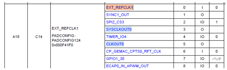

Hi Board Designers
Inputs related to IBIS model:
My customer will use CLKOUT0 for clock source of external PHY and they would like to simulate signal integrity. He got IBIS model of 1_AM62_sprm766d.ibs, but only EXT_REFCLK1 is assigned to A18 pin and CLKOUT0 looks not available.
Could you please provide IBIS model of CLKOUT0?
The pin name is more of a syntax convention in the IBIS model. What really matters is the actual model which is LVCMOS_V. The IO model will not change depending on the mux mode selected but the way the user hooks it up in their simulation will. Here is a screenshot from one simulator tool to illustrate the different models available for that pin (LVCMOS_V in 1.8V or 3.3V mode).
