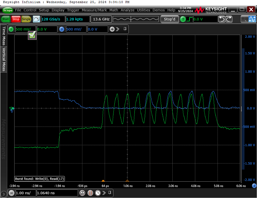

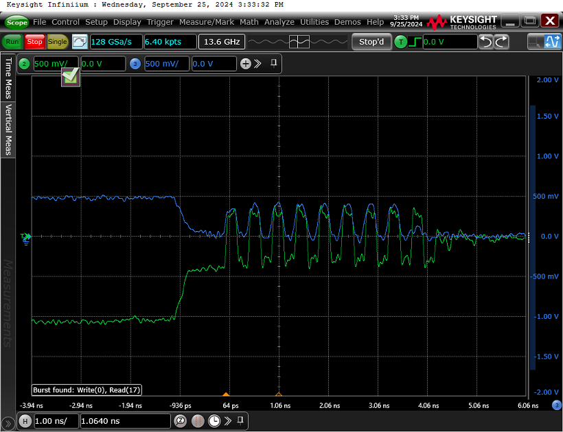

Our customer was performing compliance testing for LPDDR4 on their custom board and found an issue with write access. There is almost no skew between DQS and DQ, and DQS and DQ appear to be in phase. On the other hand, there are no issues with read access.
DQS to DQ Skew with write access:
DQS to DQ Skew with read access:

Our customer is concerned that Write DQS2DQ Training did not work correctly.
Can the phase between DQS and DQ be manually adjusted? If so, how?
    The LPDDR4 memory uses an un-matched DQS-DQ path (inside the memory); thus during a WRITE, the DQS strobe must arrive at the SDRAM ball prior to the DQ signal by the amount of tDQS2DQ. (which can range anywhere from 200 to 800 ps).
    The DQ is center aligned to the strobe only at the DRAM internal latch, which is not accessible with a scope / probe.

    No - the timing relationship between DQS and DQ is set through write DQ training, which is performed during the initial boot as well as periodically during mission mode.
    Or does that mean the Write DQS2DQ Training did not work correctly?
    If so, why did the Write DQS2DQ Training not work correctly?
    No, it does not mean that training did not work correctly. The points I was trying to make are:
    1. You cannot probe what the internal latch of the memory observes (and it is at the internal latch where the DQ must be center-aligned to the strobe)
    2. Any WRITE measurement illustrating DQS vs. DQ on the PCB will have some delay offset between 200 to 800 ps which may give the illusion that the DQ and DQS "are in phase".
    I do not know what data pattern is being transmitted on the bus during the provided waveform, but there seems to be a clear delay between DQS and DQ as the DQ signal is still switching during the DQS postamble phase.
