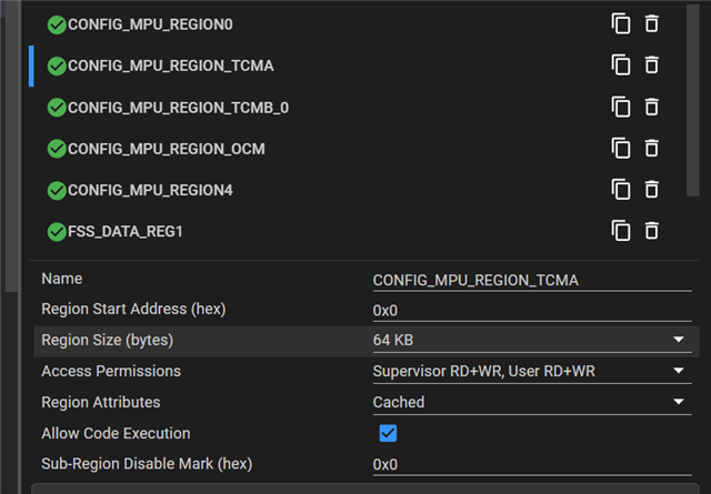

Therefore I modified TCMA region size to 64K and and TCMB region size to 192K.
MPU config is the following :
TCM A:
TCMB:
For now, I'm trying to put the stack segment in TCMA see below.

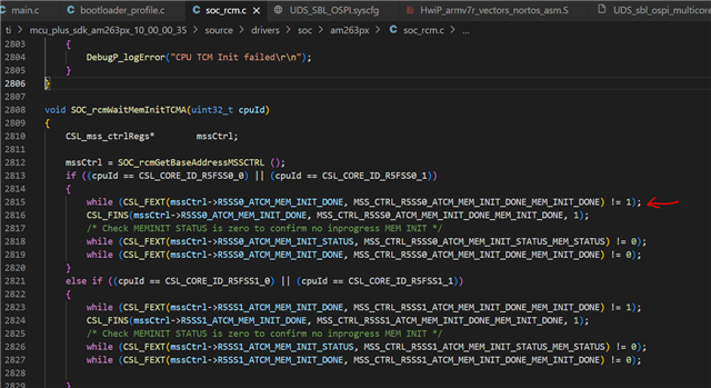

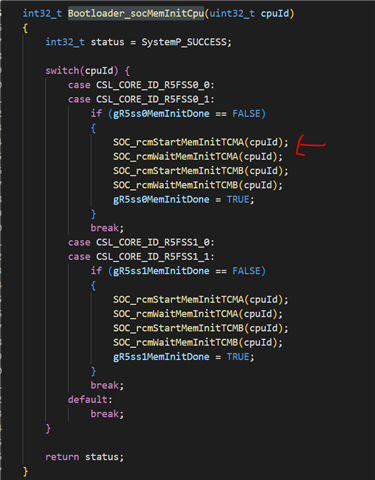

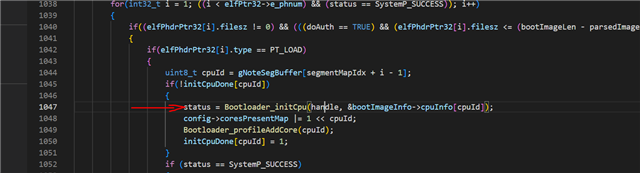

When executing the code, the execution proceeds until this where the code calls for bootloader_InitCpu
Which in turn calls Bootloader_socMemInitCpu
Then get stuck in a while loop waiting for TCMA initialisation or triggers a reset.

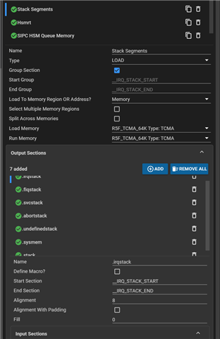

    Coming back to pushing the stacks to TCMA, my current project has .sysmem & .stack grouped with other stacks and the whole group running from TCMA. See extract from linker script.
    GROUP  :   {
        .irqstack : {
            . = . + __IRQ_STACK_SIZE;
        } align(8)
        RUN_START(__IRQ_STACK_START)
        RUN_END(__IRQ_STACK_END)
        .fiqstack : {
            . = . + __FIQ_STACK_SIZE;
        } align(8)
        RUN_START(__FIQ_STACK_START)
        RUN_END(__FIQ_STACK_END)
        .svcstack : {
            . = . + __SVC_STACK_SIZE;
        } align(8)
        RUN_START(__SVC_STACK_START)
        RUN_END(__SVC_STACK_END)
        .abortstack : {
            . = . + __ABORT_STACK_SIZE;
        } align(8)
        RUN_START(__ABORT_STACK_START)
        RUN_END(__ABORT_STACK_END)
        .undefinedstack : {
            . = . + __UNDEFINED_STACK_SIZE;
        } align(8)
        RUN_START(__UNDEFINED_STACK_START)
        RUN_END(__UNDEFINED_STACK_END)
        .sysmem : {
        } align(8)
        .stack : {
        } align(8)
        } > R5F_TCMA_64K
    Core 0 & 1 work in lockstep. Only Core 0 is defined in the SBL project.
    The application that will be booted has Core 0 & 1 working in lockstep, Core 2 & 3 working as standalone.
    The rest of the setup is identical to the example. I'm running into the issue described above.
