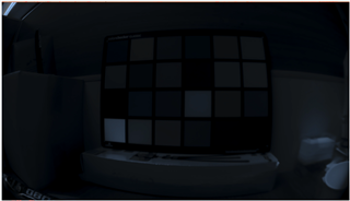

Then I tried those generated parameter files with generate_dcc.sh.
When I apply dcc bins generated by generate_dcc.sh results in very dark output as below.
< image_viss_dcc_bins.yuv >
I don't think even the tuning result of CFAI plugin updated by the tool isn't correct, but more frustrating thing is that the dcc bins generated by the xml files from that plugin results in wired and different output.
There must be something I'm missing.

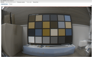

    After checking the default result above, I tried RGB2RGB tuning as you said, following the guide,
    the result is as below.
    < image_viss_dcc_bins_rgb2rgb_tuned_20241212.yuv >
    I can't tell the tuning actually takes effect. I don't see the difference.
    This was the reason I tried CFAI3 CCM in the first place.
    Anyway, I tried RGB2RGB tuning as below following the TI guide.
    first, I set the input raw image and marked the checker box region
    second, also set the reference checker image which was included in dcc tool and marked the checker box region.
    Then I processed the plguin, and I got the result as below.
    The preview above was not very good, but I could see a little bit improvement at least.

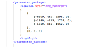

    But as I already stated above, the actual viss output wasn't like the plugin result preview, and little different from the default as I saw.
    There were some differences in the matrix generated by the tool between displayed one on GUI and the one in xml file,
    and I tried both, the results were the same.
    I even tested the extreme setting to see if the rgb2rgb matrix actually worked, by modified the matrix as below.

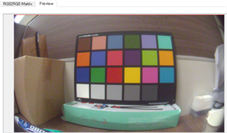

  • I have found the reason the rgb2rgb matrix didn't take effect.
    It turned out that the missing implementation of getExpRrg callback in my sensor driver seemed to casue the problem.
    I have set aewbMode as ALGORITHMS_ISS_AEWB_MODE_AE and implemented getExpPrg by referencing sensor drivers, as following,
    After the setting of aewbMode and implementation of getExpPrg, the rgb2rgb matrix is applied to the viss output.
    And furthermore, I have got the color matrix which results in quite good color output on rgb2rgb plugin preview result.
    Now I only need the actual viss output should come out as the rgb2rgb plugin preview result,

  • Hi Juhyun,
    That looks correct RGB color, but that is without any color correction applied.
    This is what you shall get in tuning tool for the raw image sample you shared previously.
  • Wow, that is perfect. How could you get the color with the image I shared?
  • Hi Juhyun,
    It is the same process as outlined in the app note https://www.ti.com/lit/pdf/sprad86
    You just need to use the "color correction" plugin of tuning tool, choose the "semi-automatic" mode, and input the raw image and the decompanding knee points.
  • but I just ended up with different and weired result as below.
    I am not sure why you have the dark output YUV image.
    Your share raw image looks OK to me.
    You may try the latest python script in the link below as I have updated it recently.
    https://git.ti.com/cgit/processor-sdk/imaging/tree/tools/default_DCC_profile_gen?h=main
    For your sensor, you may use the settings below as your python script input (please change sensor id to yours).
    That works well with your shared raw sample image.

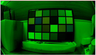

  • I followed the way you guided me to tune RGB2RGB, and I was able to reproduce the result as you did.
    Yes, it was due to the CFA format, it was YRCyY as you corrected, not RYYCy.
    Now as the CCM was secured, I tried the properties.txt you shared gererating the parameters with rgb2rgb ccm parameter tuned to check the ISP result with them on the board.
    I actually tried both configurations without YUV_GAMMA and with YUV_GAMMA after patched recently updated python scripts to generate gamma parameters that you commented on. The YUV_GAMMA version gave better contrast and brightness.
    This was the result.
    I could see the greenish color all around, but the colors themselves of the patches on the color chart seemed correct.
