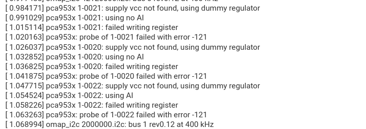

We can boot from microSD, boot from eMMC. But when we redesign our hardware and tried to boot from microSD
the kernel stuck at about 2second , uart_log-1127.txt is from TI , kernel_fail.log is from our hardware. We compare the log difference at about kernel start up at 2 seconds.
1. Can you give us the guide of how to solve the kernel hang ?
From the log 4fb0000.mmc is microSD card device(root), why the message "platform 4fb0000.mmc: deferred probe pending" show up?
[ 2.176713] Waiting for root device PARTUUID=076c4a2a-02...
[ 12.359017] platform 4fb0000.mmc: deferred probe pending
I notice that there is no detect pin at microSD card connector at our hardware design. There is detect pin microSD card connector at The TI j721s2-evm
Can you give us microSD Card detect pin- software change guide?
I changed this file arch/arm64/boot/dts/ti/k3-j721s2-common-proc-board.dts , but no difference of the boot result.
