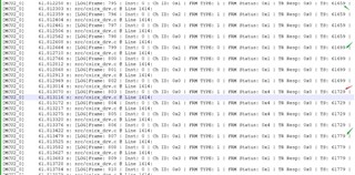

  • Besides, in the CSIRx driver, after enabling CSIRX_DRV_ENABLE_DEBUG, customer observed a phenomenon while reproducing Short/Long Frame errors. When an error frame occurs, the timestamp difference between the current error frame and the previous frame is not the expected 40ms (camera frame rate is 25fps). What could be the possible reason?
    As shown in the figure below, frame status 0x1 indicates FVID2_FRAME_STATUS_COMPLETED, and frame status 0x4 indicates FVID2_FRAME_STATUS_ERROR. The timestamps (TS) for four consecutive frames are 61659, 61699, 61729, and 61779. The timestamp difference for the error frame is 61729 - 61699 = 30ms, which is less than the expected 40ms.
    Below is the log.
    mcu20_csirx_debug.txt
  • Hi Xingyu,
    Its surprising that you are getting error frames within 30ms. That shouldn't have happened.

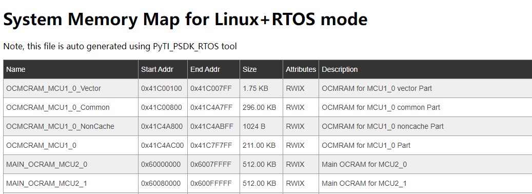

    Could you please confirm that OCM memory in MCU domain is available for CSIRX to use? I mean are you using SBL or BootApp? They both use OCM memory.
    Brijesh
    Customer OCM usage is as below:
  • Hi Xingyu,
    Do they also use Main Domain OCM memory?
    Brijesh
  • Hi Brijesh,
    We are not very sure. Customer checked the system_memory_map and listed all the items related with OCMRAM and OCRAM.
  • Hi Xingyu,
    I asked because i see sections allocated in OCM memory like "Vector" "Common" and "NoCache", so wondering if Main Domain OCM memory is also used.
    I am assuming that that it is not and will use it to store some internal data of CSIRX driver.
    Can you also pleas confirm that customer is using only CSIRX instance0 and they are using it for capturing 4 channel/camera data? Because this memory is small, it may not be sufficient to fit complete data for all instances and channels.
    Brijesh
  • Hi Brijesh,
    Yes, customer is using CSIRX0 for capturing 4 camera data (1920x1536).

              We did a test,  change L3_MEM_SIZE from 512KB to 256KB (not add section csirx_desc_mem), mcu2_0 works fine.So L3_MEM_SIZE 256kb should be enough.
              After applying the OCRAM patch,  the app (running in A core) gets stuck in the function ownGraphNodeKernelInit() during the execution of vxVerifyGraph() in tiovx/source/framework/vx_graph_verify.c, which prevents the camera’s initialization and streaming from proceeding. We guess something goes wrong with mcu2_0. We are looking into it  and add more debug info, since we are not quite familiar with CSS tool.
  • dear expert,
          After applying the OCRAM patch,  all the file we need to update to the borad is  vx_app_rtos_linux_mcu2_0.out , not need any other file?
  • Hi zhao li,
    This requires to just change mcu2_0 firmware, as this OCM memory is not used on mcu2_1 or anywhere else. Can you please share the map file for mcu2_0?
    Brijesh
  • Dear expert,
               I reproduce the stuck issue with demo vx_app_multi_cam.out. After applying the OCRAM patch,  app vx_app_multi_cam.out  also  gets stuck in the function app_verify_graph()  during the execution of vxVerifyGraph() in vision_apps/apps/basic_demos/app_multi_cam/main.c, log listed below:
            This will be helpfull for you to reproduce the stuck issue after applying the OCRAM patch.
    Zhao Li
  • Hi Zhao Li,
    ok, let me try it on EVM first and share you the changes.
    Brijesh
  • Dear expert,
           After applying the OCRAM patch, mcu2_0  gets stuck in CSL_udmapCppi5SetDescType(pTrpd, descType)  , right at the beginning of
    CsirxDrv_udmaRxTrpdInit(),pdk_j721s2_08_06_01_03/packages/ti/drv/csirx/src/csirx_drvUdma.c。
    Zhao Li
  • Hi Zhao Li,
    That's surprising. Can you please check the pTrpd address and see if it is pointing to correct OCM memory? Also can you please check from the CCS memory window if this area is accessible? Most likely this area should be mapped, but if not, can we please add this mapping in the MPU?
    Brijesh
  • Dear expert,
              "Can you please check the pTrpd address and see if it is pointing to correct OCM memory?Also can you please check from the CCS memory window if this area is accessible?"
                    Yes,address is in the range of {0x60040000, 0x60080000},can not read or write.
                I tried the following patch,  change mem addr translate size to MAIN_OCRAM_MCU2_0_SIZE, which can fix mcu2_0 stuck issue due to OCRAM patch.
            A new problem has emerged,demo vx_app_multi_cam.out get stuck in vxGraphParameterDequeueDoneRef() after run vxGraphParameterEnqueueReadyRef 4 times. I add debug “ GT_0trace(CsirxTrace, GT_ERR, "CsirxDrv_udmaCQEventCb receive dma completion event\r\n");” in CsirxDrv_udmaCQEventCb() pdk_j721s2_08_06_01_03/packages/ti/drv/csirx/src/csirx_drvUdma.c, and only see debug only print 4times。So I guess mcu2_0 do NOT receive UDMA_EVENT_TYPE_DMA_COMPLETION event.
    Zhao Li
  • Hi Zhao Li,
    Yes, it needs to be mapped and since it is mapped, we need to do it bit differently. When it is mapped, only mcu2_0 can use this mapped address, but for dma engine, we need to use physical address, so this change required in the driver..
    When descriptor is submitted to the Ring and when Ring is used for the channel, both of these places require to be physical actual address. Can you try making these changes in CSIRX driver and see if it helps?
    Brijesh
  • Dear expert,
         We have tried several ways in the last few days,like adding memory map in arch/arm64/boot/dts/imotion_d4/k3-j721s2-rtos-memory-map.dtsi in linux kernel,but can not make mcu2_0 and dma engine both work file。
         Can you help to share the full changes including previous OCRAM patch?
    Zhao Li
  • Hi Zhao Li,
    Sure, let me try it out on EVM and give you the exact patches.
    Brijesh
