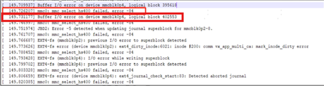

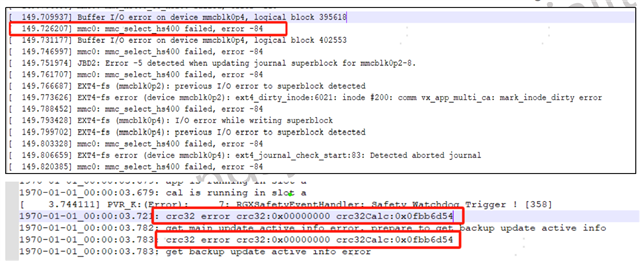

    2、We found that when problems occurred, there were many IO error reports in the SOC log. What reasons can trigger IO errors?

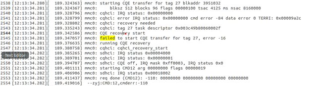

    When problems occur, from the commands of the logic analyzer, we can find that after the emmc receives CMD46 and completes the data transmission, it receives CMD12 from the SOC and then CMD48. At this time, the response data of the EMMC is 00 40 09 00, indicating that the previous CMD12 is an illegal instruction.We captured the complete command interaction process before and after the problem occurred. As shown in the figure, after the problem occurred, the speed was reduced to HS, then re-tunned to HS200, and then switched to HS400. After running for a period of time, it would again slow down and re-tunning for the same reason, and this cycle would continue.
    Q1:What is the reason that the SOC sent the CMD12 instruction
    Q2:The CMD48 instruction 00 40 09 00 replied by emmc indicates that the previous CMD12 is an illegal instruction. Will this affect the SOC logic determination

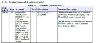

    4. Again would you please share how to interpret the argument and CRC for each command and response that captured by logical analyzer?
    let me take CMD44 as example.
    I think I can parse the command CMD44.
    CMD44: 40050018
    DD: 1
    task id: 5
    number of blocks: 0x18
    R1: 00000B00
    How to parse the response?
    here is the definition in JESD84-B51A.
    thanks a lot!

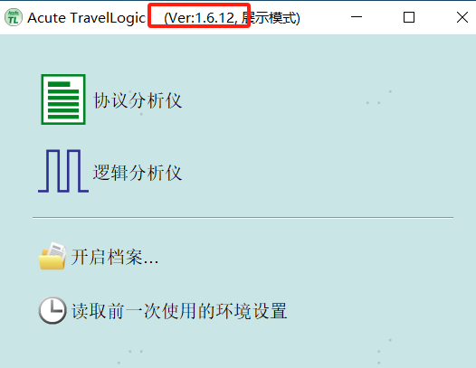

    We  shere the complete logic analyzer log to you.
    You can use the Acute TravelLogic ver 1.6.12 ; you can download by www.acute.com.tw
    In addition ,We will add more logs to identify the cause of the problem and reproduce the following two log entries that have issues.
    The first CQE recovery and CMD12  -110
    The second CMD 35 error

    have asked customer xinfa to upload the logical analyzer tool, it can parse above log. Please help check the log.

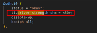

    Suggestions:
    • Increasing the drive strength in Linux ideally improves the signal quality and could help. Can you try with that?
    Gokul
  • Hi,Gokul:
    we try change drive strength in dts;
    we Configuring DR_TY at 44 ohms or 30 ohms  does improve things, but it doesn't solve the problem.
    The other values have not improved.
  • Hi zhu,
    You have changed this property in dts to 33 ohms right .
