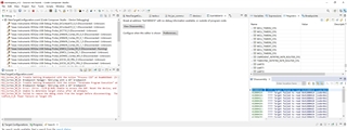

  • Hi
    I used my own uboot.img and recompiled the keywriter, but I commented out the OTP_VppEn(); and
    status = Sciclient_otpProcessKeyCfg((uint32_t *)keywriter_cert,
                                        SCICLIENT_SERVICE_WAIT_FOREVER,
                                        &debug_response);
    code segment in the source code to test whether the board has entered the keywriter burn-in process. However, there are no logs printed on the serial port. The image is the log captured by JTAG. How can I confirm where the program is running? Could you please help analyze this?

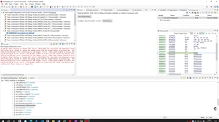

  • Hi
    I made the changes following this link ([FAQ] TDA4VM-Q1: SR2.0 update Keywriter process) and added my own logs, but strangely only the middle part of the logs is printed out. The logs I added at the beginning and the end are not printed, and it seems that the state of the keywriter is also not correct.Below are the images with added logs and debugging results。
    Br
    zhangbo

  • Hi Zhang,
    What are these two pictures representing?
    The right-side picture showcases that you are still stuck in MCU ROM code, implying your tiboot3.bin image is not signed properly or has authentication issues.
    Your left-side picture shows the MCU R5F in an exception state, not sure when this was arrived at.
    regards
    Suman
