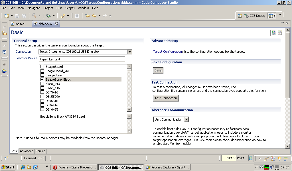

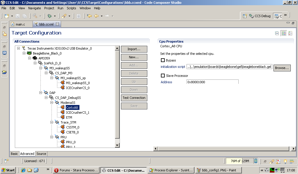

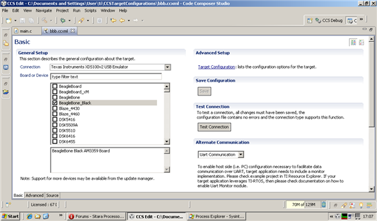

    If you create a target configuration for the "BeagleBone_Black" board:
    It should select a gel file to initialize the hardware:
    Is there a GEL file in your target  configuration?
  • yes, it does have gel file. I also checked the contents of the file and it says this :
