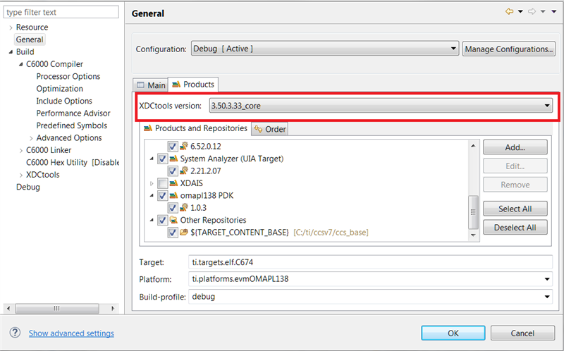

When I Install  pdk_omapl138_1_0_3 sdk and run spi looback example I get the following error. I am using ccs 6.0.0.00190.
Description : #20 identifier "Error_IGNORE" is undefined

"C:/ti/bios_6_52_00_12/packages/ti/sysbios/knl/Swi.c", line 483: error #20: identifier "Error_IGNORE" is undefined
>> Compilation failure
1 error detected in the compilation of "C:/ti/bios_6_52_00_12/packages/ti/sysbios/knl/Swi.c".

    Can you try updating the CCS?
    Best Regards
    Yordan
  • I updated ccs v8 but still I am getting the following error.

  • Hi Navaneetha,
    Your project is pointing to the wrong version of XDCtools. It should be pointing to xdctools_3_50_03_33. You can change this by going to Project Properties->General->Products as shown below.
