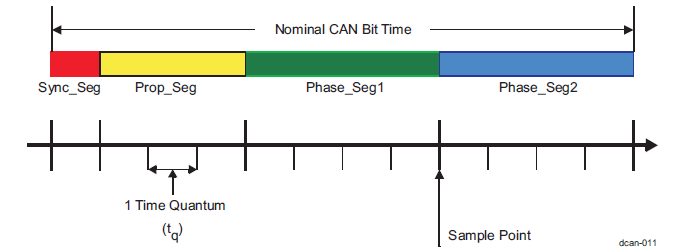

    Bit rate calculation
    bit rate(bits per second) = (CAN clock in Hz) / BRP / (1 + TSEG1 + TSEG2)
    where:
    CAN clock is functional clock of CAN module (80MHz by default in TDA4)
    BRP: Bit rate pre-scalar value
    TSEG1, TSEG2: Time segments used to define sampling point for the bit.
    TSEG1: Time before the sampling point = Prop_Seg + Phase_Seg1
    TSEG2: Time after the sampling point = Phase_Seg2
    1: added for the Sync_Seg
    Sampling point calculation
    Sampling point is the point of time at which the bus level is read and interpreted as the value at that respective time. Typical value of sampling point is between 75-90%.
    Sampling Point(%) = (1 + TSEG1) / (1 + TSEG1 + TSEG2)
    NOTE: +1 needs to be added in this formula to the BRP, TSEG1 and TSEG2 values while computing the sampling point due to implementation details.

    In this configuration we see Prop Segment value, Phase Segment 1 & 2. These are the same as we see in the diagram above.
