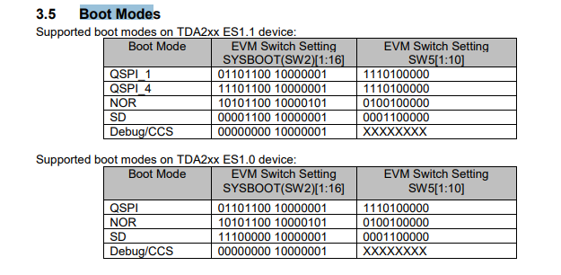

The use-guide (file::/PROCESSOR_SDK_VISION_03_07_00_00/vision_sdk/docs/Linux/VisionSDK_Linux_UserGuide.pdf) has steps to flash the images to QSPI memory from the host machine, for this we need to connect a USB cable from P2/USB1 to host PC. This is used for flashing the EVM using fastboot.
In our custom board, we don't have a P2/USB1 port. So can you share the steps to flash images to the QSPI memory from the u-boot prompt?

    • Create a folder called "qspi" in the SD card bootable partition & copy all required image into this folder(uImage, dtb, firmware, MLO, u-boot)
    • Change the switch settings on the EVM to as below for SD boot mode
    • Reboot the board with the SD-card. Halt at u-boot and run the below commands

    • After this is complete, the contents are copied to QSPI. Now change the switch settings to QSPI boot mode. The SD-card can be removed from the board if the rootfs file system is already in eMMC.
    • Reboot the board, you'll notice log "Trying to boot from SPI" in the terminal.
