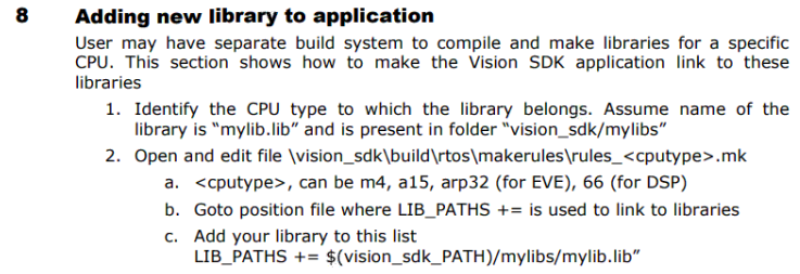

[FAQ] TDA2E: How to link the static library in the Vision SDK bios
Part Number: TDA2E
Can I know the steps for linking new static library into the Vision SDK?
