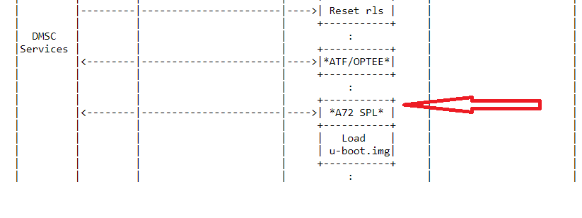

Trying to boot to u-boot prompt using PSDKLA & we see that A72 SPL hangs:
"spl: mmc init failed with error: - 110".
How to fix this and get to u-boot prompt.
  • The j7 boot flow is explained here: https://git.ti.com/gitweb?p=ti-u-boot/ti-u-boot.git;a=blob_plain;f=board/ti/j721e/README;hb=HEAD
    R5 SPL does not support UHS hence issues related to UHS do not occur at the R5 SPL stage.
    The error is because the A72 SPL supports UHS for SD cards. UHS stands for Ultra high speed.
    The UHS feature needs a switch of vqmmc supply voltage from 3.3V to 1.8V. In case the regulators
    are not populated the switch fails and hence the A72 SPL hangs at that stage.
    So we can disable the UHS feature to quickly get to u-boot prompt. By following steps:
