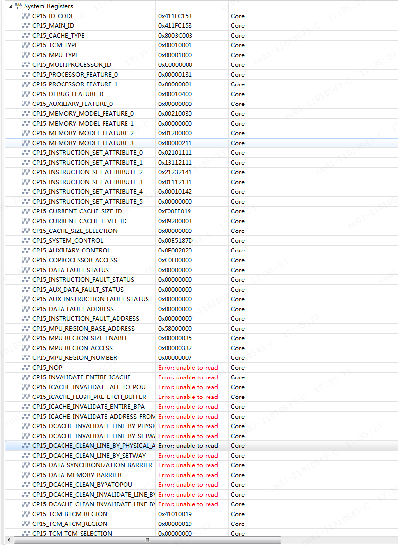

I want to check if R5F's Instruction and Data Cache is enabled or not.
Attaching the System Register. Please help me check if I can get the above information from the System Registers:

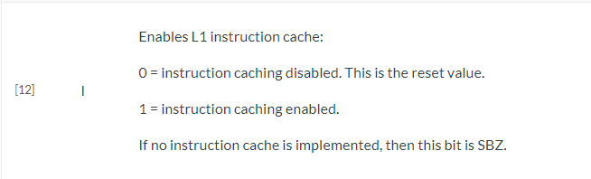

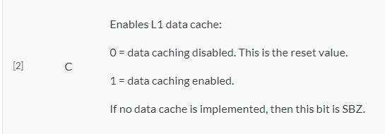

    If you check the R5F TRM (https://developer.arm.com/documentation/ddi0460/c/System-Control/Register-descriptions/c1--System-Control-Register?lang=en ) section 4.3.16 c1, System Control Register, you will see the following:
    1. 12th Bit (I bit) determines if the I cache is enabled or not
    2. 2nd Bit (C bit) determines if the D cache is enabled or not
    This register can be read from CCS via the Register -> System registers -> CP15_SYSTEM_CONTROL register.
    For you application, I see the value as 0x00E5187D - here both the I and the C bits are 1, hence we can confirm that the I cache and the D cache are both enabled.

  • Hi,Karan
    Thank you very much for confirming this information for me, it is very useful to me, thanks again!
