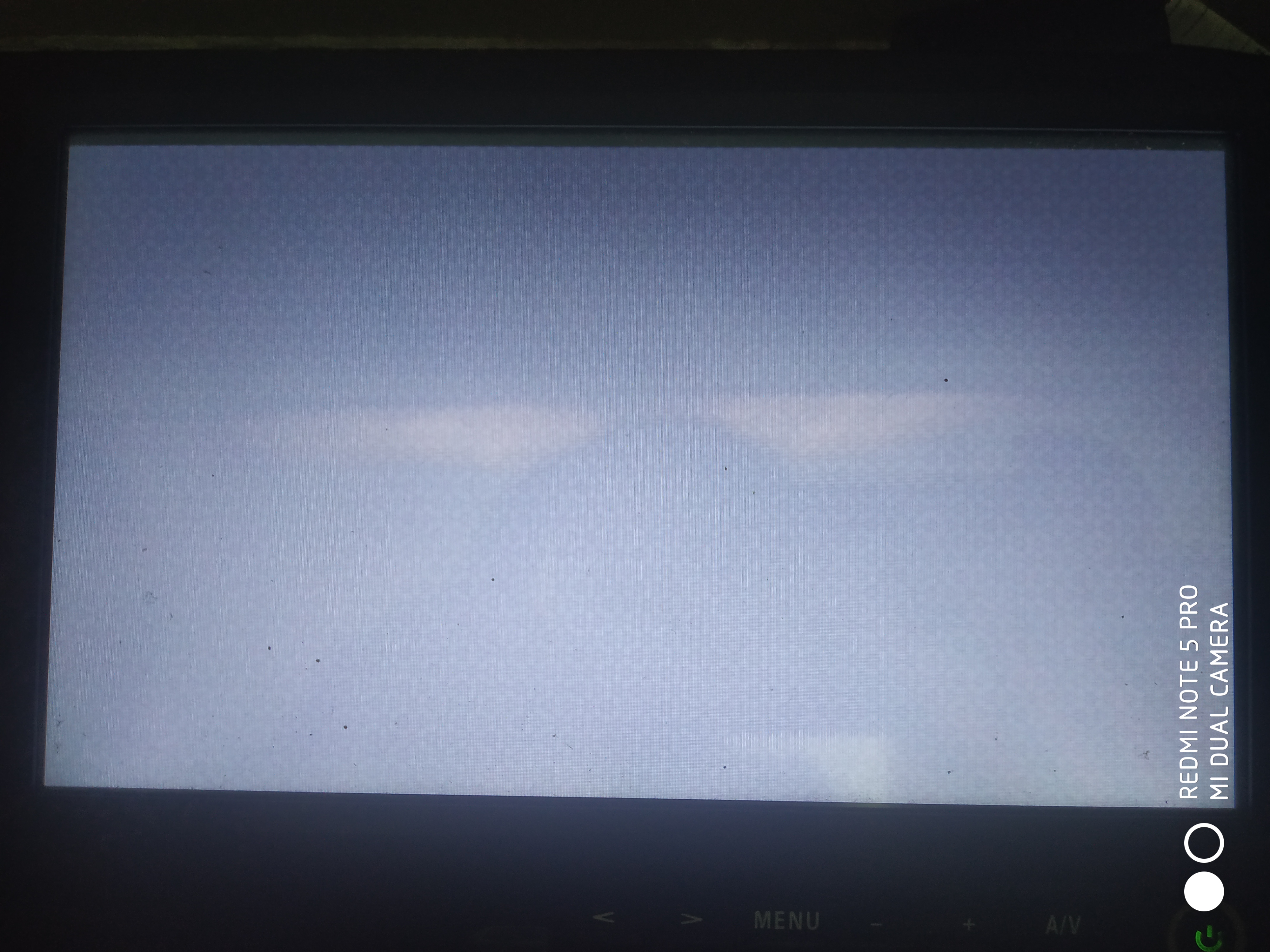

    Now you can see the Weston background on the display as below.

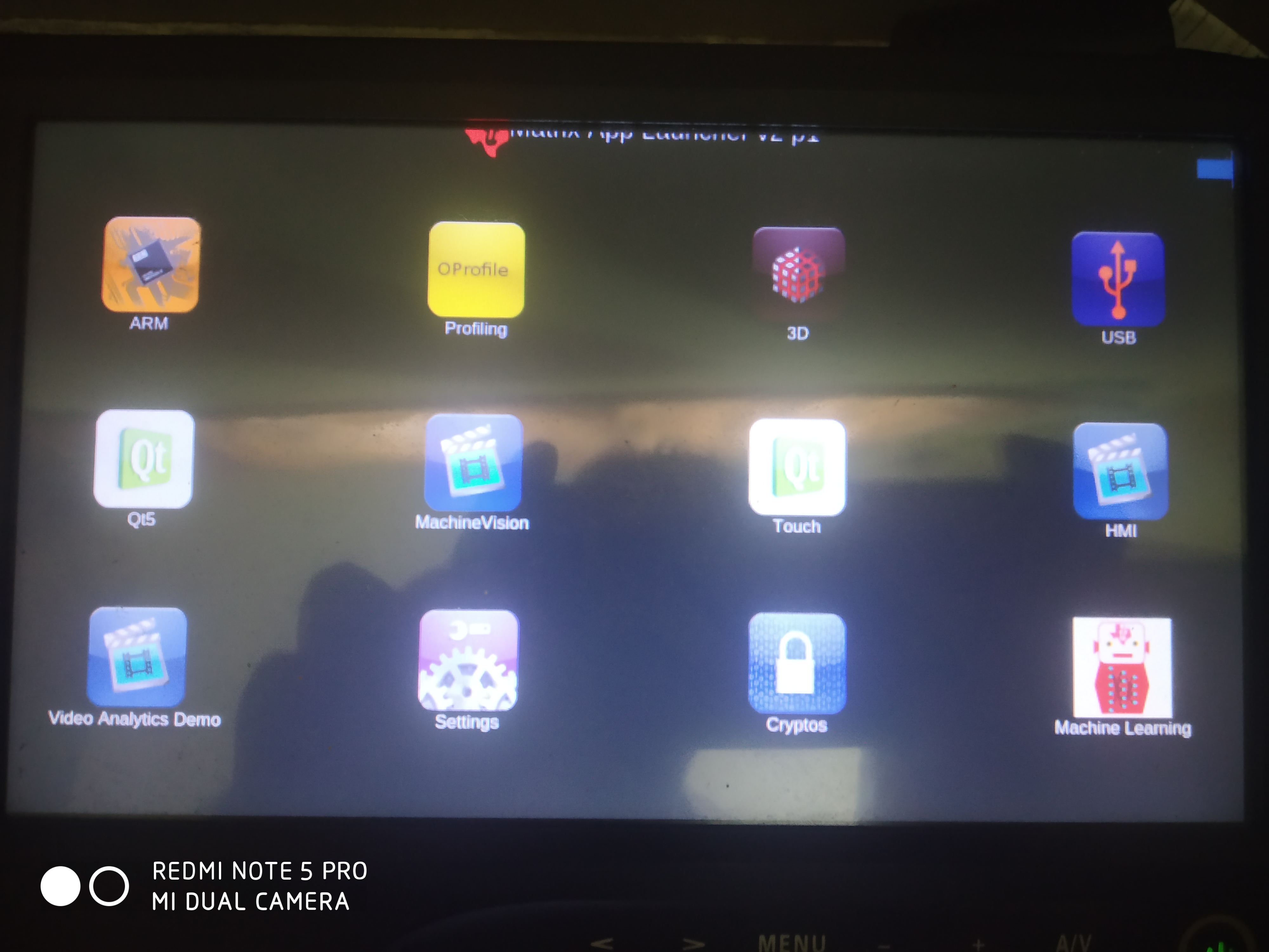

    Case 2: In this case the weston application is running in the background & other application is running in the foreground, so we need to kill the foreground application inorder to view the Gstreamer O/P on the display
    Ex: If the Matrix-GUI application is running in the foreground, run the below command to stop the Matrix-GUI application
    • /etc/init.d/matrix-gui-2.0 stop
    The Matrix-GUI application looks like as below.
