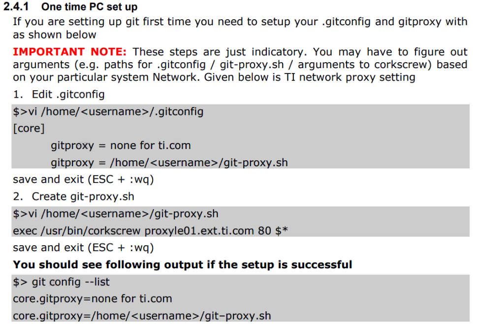

    • Git setup is needed to clone the Kerenel, U-boot & SGX component, etc
    • Clone the Kernel, U-boot & SGX component, etc

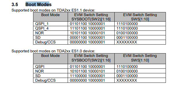

    • Change the SYS-BOOT switch setting to SD boot mode

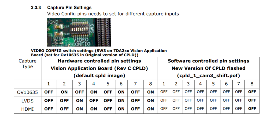

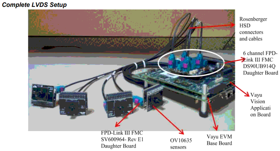

    • Refer the user-guide to know the board setup & capture pin setup for LVDS use-case

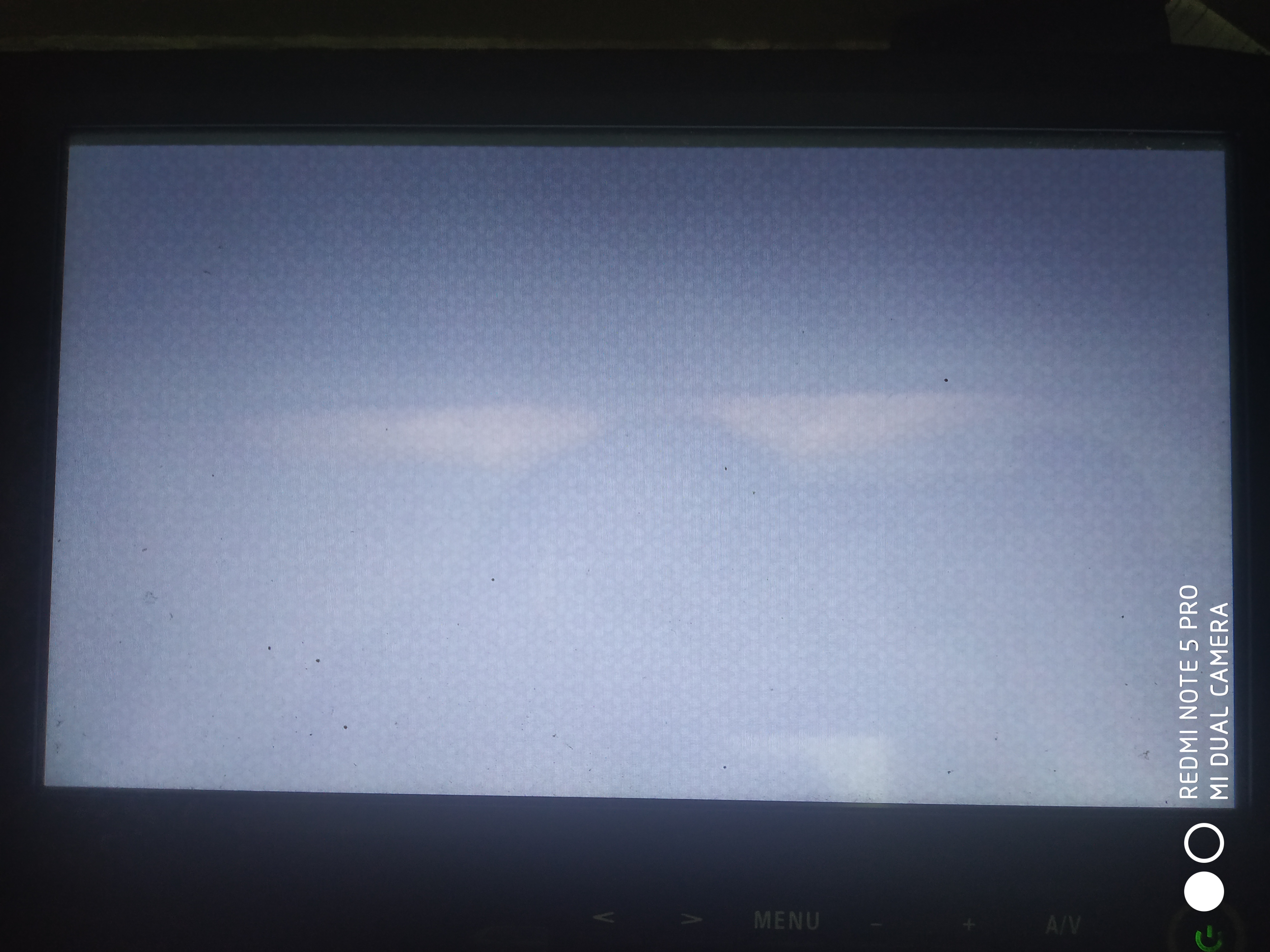

    • Now you will see the camera captured O/P on the display & you should see the log as below for SD boot mode

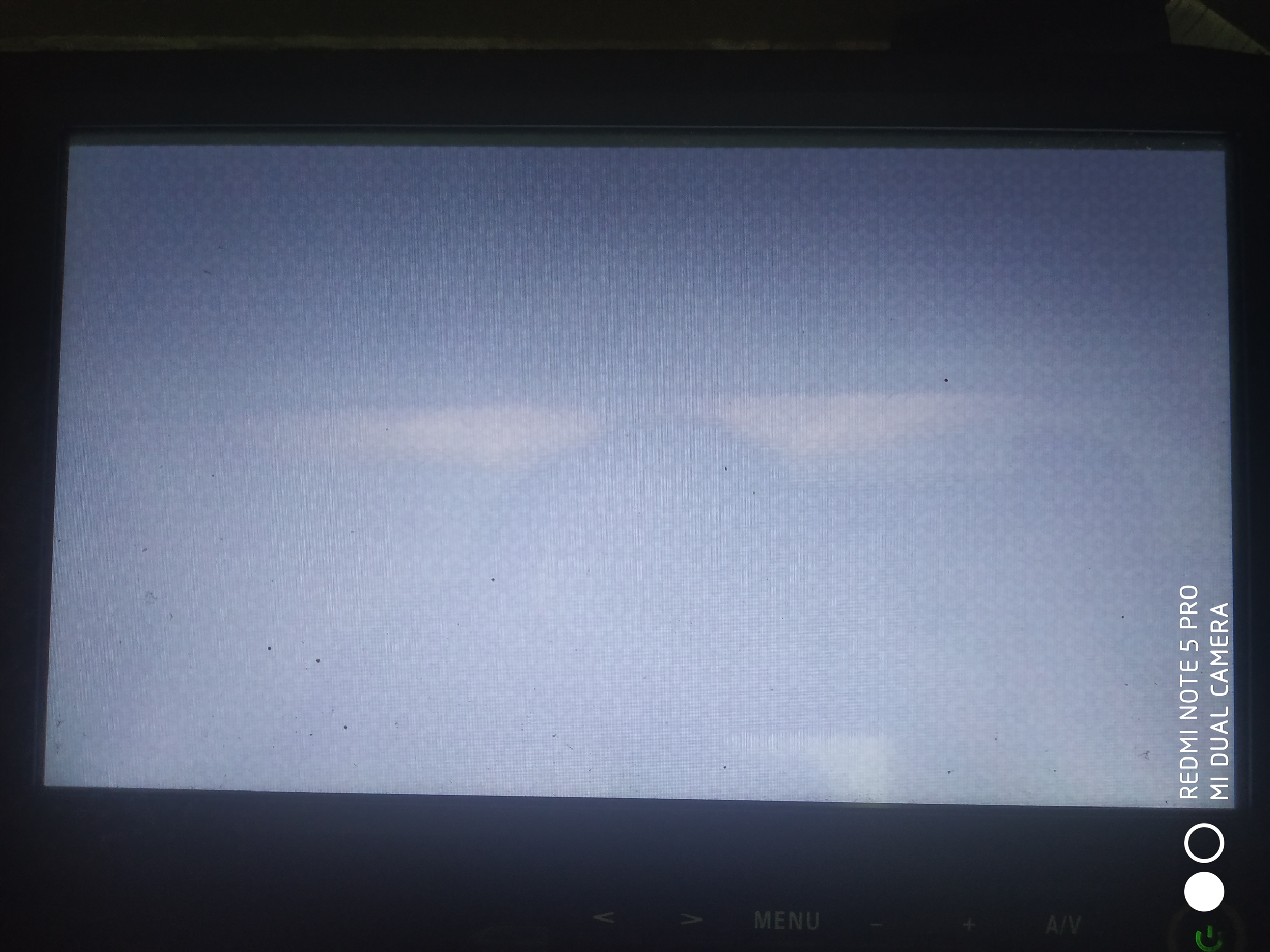

    • Now you will see the weston background on the O/P display
