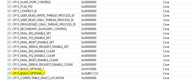

How can I check if R5F is running in lock-step or split mode? Is there some register I can look at?
  • The c15, Build Options 2 register can be used to check this.
    To view this register we can use CP15 registers from System Registers.

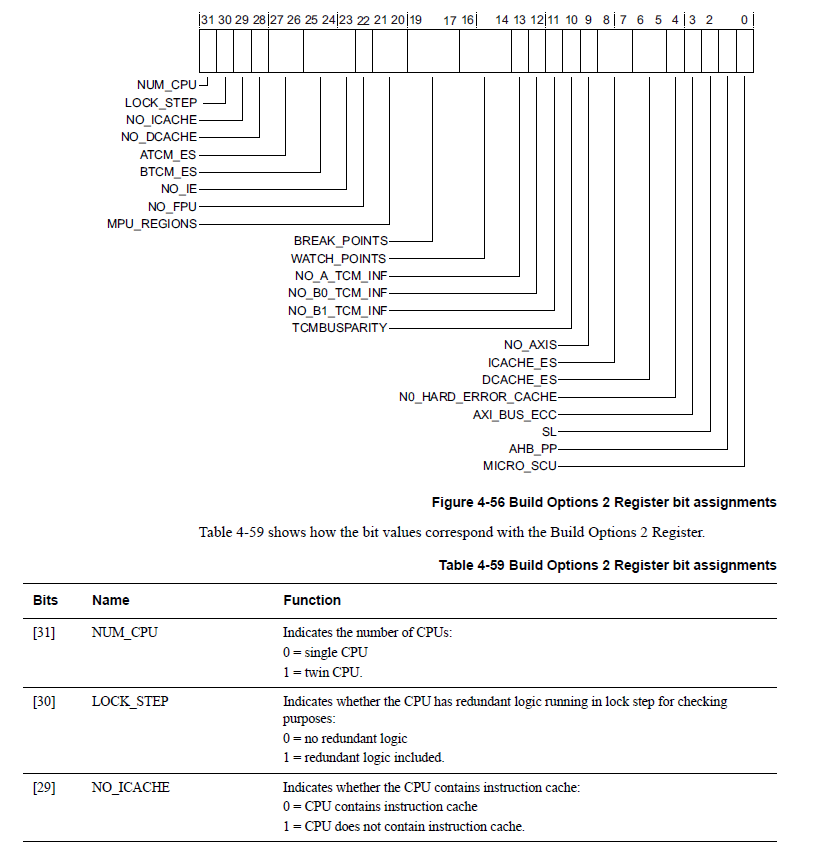

    Registers -> System_Registers -> CP15_BUILD_OPTIONS_2 register. The bit 30 (LOCK_STEP) here denotes if the R5F is in Lock-step or split mode.
    30th Bit:
    0 :: Split mode
    1 :: Lock step mode
