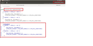

  • Dear Experts :
    Follow previous discussion, I make some update :
    1.  Hardware, csi0, I2C3_SCL / I2C3_SDA ( ) --> MMC2_CK(T26) / MMC2_CMD (T25), the define should be same as EVB
    2.  Hardware, csi1, I2C6_SCL / I2C6_SDA ( ) --> I3C0_SCL (W2) / I3C0_SDA (W1)
    3.  base on new pin define, we generate new  "J721E_pinmux_data.c", and re-build in vision_app
    4.  base on new pin define, we generate new dts "k3-j721e-common-proc-board", and re-build kernel
    but It does not work.
    pls, check appendix files
    Do I miss something?
    Many Thanks.

    (5) check "J721E_pinmux_data.c"
    static pinmuxPerCfg_t gI2c6PinCfg[] =
        /* MyI2C6 -> I2C6_SCL -> W2 */
           PIN_I3C0_SCL, PIN_MODE(4) | \
            ((PIN_PULL_DIRECTION | PIN_INPUT_ENABLE) & (~PIN_PULL_DISABLE))
        /* MyI2C6 -> I2C6_SDA -> W1 */
            PIN_I3C0_SDA, PIN_MODE(4) | \
        {PINMUX_END}
    static pinmuxPerCfg_t gI2c3PinCfg[] =
        /* MyI2C3 -> I2C3_SCL -> T26 */
            PIN_MMC2_CLK, PIN_MODE(4) | \
        /* MyI2C3 -> I2C3_SDA -> T25 */
            PIN_MMC2_CMD, PIN_MODE(4) | \
        {PINMUX_END}

  • Hi Gibbs,
    Sorry i did not the question.
    Do you mean, after disabling i2c3 from Linux dtb files, you are able to communicate with sensor?
    and now i2c6 is not working?
    It looks like i2c6 is on difference pad/pins. So we need to change pinmux in the app_pinmux.c file. Can you please try changing it?
    Brijesh

    try to modify this file & re-build it :
    vision_apps\utils\misc\src\app_pinmux.c
        //Gibbs@0325, original EVB
        /* MyI2C6 -> I2C6_SCL -> AA3 */
        //    PIN_SPI0_D1, PIN_MODE(2) | \
        //    ((PIN_PULL_DIRECTION | PIN_INPUT_ENABLE) & (~PIN_PULL_DISABLE))
        /* MyI2C6 -> I2C6_SDA -> Y2 */
        //    PIN_SPI1_D1, PIN_MODE(2) | \
        //Gibbs@0325, Our Board
        {PINMUX_END}

  • Is this correct mapping?
        {PINMUX_END}
