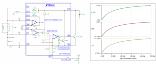

    XTR105 can be used for measure thermistor and convert the voltage to 4-20mA. The circuit looks similar to the image below, which it use the IC's constant current source to drive the bridge or NTC to generate voltage difference and converted to current. The voltage difference is directly proportional to temperature via the NTC temperature curve or calibrated temperature range.
    We have XTR115/XTR116/XTR117 or XTR111 that can be used for convert the Voltage to 4-20mA. We can use a voltage source to drive NTC, where Vout is function of temperature via the voltage divider, and use XTR11X IC to convert to 4-20mA current loop.

    Your thermistor application is operating such a wide temperature range from ~700kΩ down to <100Ω range (-45C to 105C) per the thermistor curve. By the analog circuit alone, it is difficult to make accurate temperature measurement from the non-linear curve in the entire temperature range.
    Now, i need to make the other module NTC module which will give precise output 4-20 mA same like RTD.
    All the V-to-I conversion is precise from the voltage to current conversion. So the this part of signal conversion is not an issue.
    Since your thermistor temperature is so wide, it is difficult to keep the thermistor temperature accuracy over the entire range like RTD. In other words, temperature to voltage conversion over from -45C to 105C will have measurement errors, and the temperature accuracy requirements are difficult to meet with a simple analog circuit.
    The accuracy requirements for the thermistor is shown below. You may have to perform the NTC curve calibration and obtain the thermistor's individual curve fit (or look-up table) in order to meet these accuracy requirements from -45C to 105C.  So I do not know how to proceed in order to meet the temperature accuracy requirements.
    Even you perform some kind of Thermistor linearization, you will get something like below, where you may obtain a good linearization near 25C, but the temperature nonlinearity near the low and high temperature will not be great.

    For temperature sensing using thermistor, it would be difficult to make to linearize the entire temperature range, which you asked from -45C to 105C. As you may see that the i_out has a curvature if the temperature sensing range is wide. For the thermistor application, the sensing range must be small in order to obtain the linear behavior. And XTR105 is not going to work better than the application note below (XTR105 solution also cost higher than XTR115/XTR116/XTR117 solution).
    Thermistor NTC XTR305 030762024.TSC
    I am using 800uA constant current source, which the current source is still too large for the temperature sensing. If the constant current source may be kept below 100uA and limit the temperature sensing range in order to achieve the better output vs. input linearized range.  Alternatively, you may use voltage dividers as shown in the application note below.
