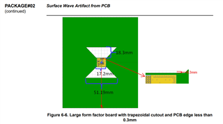

    When designing the mmWave radar's PCB for our product, our initial approach is to replicate the evaluation board's design IWR6843AOPEVM on our PCB to minimize any deviations or influences caused by design changes. However, if space constraints arise—such as positioning the mmWave radar IC (IWR6843AOP) at the center of the product what impact could this positional change (e.g., moving the IC IWR6843AOP to the center or corner relative to the evaluation board design) have on the radar's sensing performance?
    Please refer to the IWR6843AOP device errata advisory number PACKAGE#02: Surface Wave Artefact from PCB, for guidelines about device placement.
    IWR6843AOP Device Silicon Errata

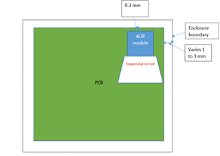

  • Hello Swarnendu,
    We are planning to place the module as shown in the image below on the PCB.
    Could you please explain the possible impact on the radiation pattern of the mmWave radar? Additionally, what would be the impact on the Field of View (FOV)? Is the above implementation correct to proceed with?
    Also, could you clarify how the trapezoidal cut distance is calculated? Lastly, what will be the impact on the FOV due to nearby components on the PCB near the radar?
    Thank you
    Dileep
  • Dileep,
    I would recommend you stick with the provided dimensions in errata for the trapezoidal cut:
    These dimensions are optimized through antenna simulations. Also, I would like to recommend the device to PCB edge distance be less than or equal to 0.3mm. This is to prevent higher order radiations as well as to prevent unwanted emissions from other PCB components affecting the antenna performance. The design you provided with one side of the device facing the PCB edge and the other having the trapezoidal cut is alright, given the cut dimensions and the device to PCB edge distances are same as what is provided in the errata.
    As an alternate workaround, as you asked, I can suggest using board to board connection. In this, the AOP device can be placed on a different board maintaining the edge to device spacings and taking out important signals out of the board to connect to the main board with other functionalities. This will help addressing area constraints.
    However, the proposed design would work fine (i.e. PCB edge at one side and trapezoidal cut out at another).
    With the recommended design, we should be able to address the surface wave artifacts. Regarding the antenna field of view, the north and south sides are anyway having no components. Considering the east and west sides, I would like to recommend placing components at least one wavelength away from the device. It is best if we can manage all other components to the other side of the PCB, but a one wavelength space is also fine.

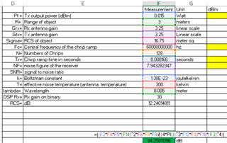

    As per your suggestion, I have attempted to collect data using the DCA1000 board and used a corner reflector with an RCS of 16.5 m², placed at a distance of 3 meters. Below are the chirp configurations I used:
     Below is the image of Post processing:
    When I am calculating the SNR by the formula you have provided, I am getting the Below output:
    However, the SNR in the two cases (from post-processing and manual calculation) does not match. Could you please suggest where I might have made a mistake? Additionally, could you prepare the calculations for the above chirp parameters in an Excel sheet for reference?
    Thank you for your time and guidance.

    I looked at your calculations. You do not have to consider the antenna gains as the EIRP and EINF numbers already include the respective antenna gains for the AOP device.
    For the temperature you can read the temp sensor values from the EVM. However, it is okay to use the ambient temperature for the calculations.
    Swarnendu

  • Hi Dileep,
    Just use the EIRP and EINF numbers as is of the device from the data sheet. That includes the transmitter, and receiver gains as well as losses. Hence, you do not require to use the antenna gains separately.
    If you would like to calculate the dBFs values, please refer to the below documentation:

    I am trying to calculate the SNR(just subtracting low velocity - High velocity) with post processing data, and I got below results from radar studio
    By Theoretical method I have calculated as below image there is difference of ~13 how could this possible do i am missing something please check.

  • Dileep,
    1. As I previously mentioned, the device data sheet spec of Tx output power is the EIRP number, and it includes the specific antenna gains as well as respective losses. Hence, it would be more accurate to use the EIRP number. If no Tx backoff is used, the typical EIRP is 15dBm. If you use EIRP, and EINF numbers, you do not require to consider the Tx and Rx gains. I can see that the formula has been updated with the gains excluded.
    2. In the noise floor calculations, the total time on target is required. Hence, even if you are observing at a single chirp response, for the noise floor calculations, you should account for the total number of chirps used.
    3. I believe that the studio based matlab runtime processing exposes all required information you should expect from the raw ADC data.
    Two additional factors are not part of the SNR formula that affects the overall noise floor. a) Additional losses b) TX-RX phase noises.  If you account for the additional phase noise introduced by the TX+RX pair, your equivalent noise figure increases by about 13dB. Hence, a difference of ~13dB between the theoretical value of SNR vs the actual value is expected.
    Swarnendu
