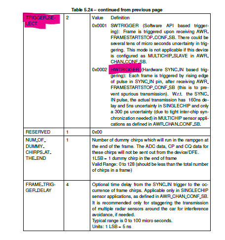

    In case, you are using STUDIO software, trigger select should be Hardware instead of software, see below.

    Yes. the understanding is correct. However, HW triggering should be selected in the MMWAVE-STUDIO software Trigger Select option for the device to recognize that each frame would be triggered by rising edge of the SYNC_IN pulse and not software API.

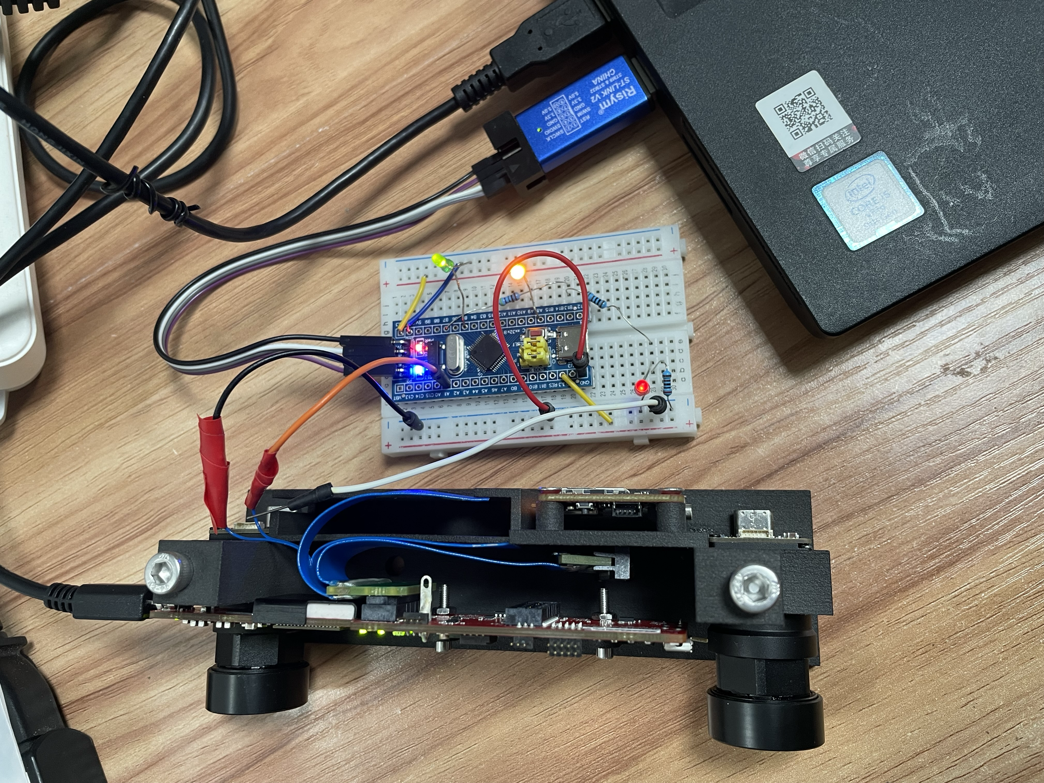

    Today I tried out the plan with a Microcontroller and a IWR6843AOPEVM, but it did not work.
    Here is my setup
    I plugged a samtec cable to the ICBoost socket(J2) on IWR6843AOPEVM, the pin 20 and pin 22 of J2 are ground, and sync_in, resp,
    I picked out the two wires for the two pins from the cable and connected them to the microcontroller pins that outputs 20 Hz PWM with 3.3 V duration at 1 us.
    The two wires from the samtec cable is the number 10 and 11 wires (corresponding to pin 20 and 22, resp.). I have double checked this.
    I welded the two wires to two extra wires for convenience. I think the welding should be good.
    The PWM output is confirmed by an oscilloscope.
    Then I ran the ROS1 driver with the below cfg, and no radar point clouds are published.

    • The SDK mentions that only software trigger is supported. This means hardware trigger is not tested in the context of the SDK demo. You can try to enable it but since it's not a supported feature we can only provide very limited support in debugging any unexpected behavior.
    • Even with mmWave Studio, hardware trigger is typically used for our frontend-only/cascade devices to synchronize frame triggering across multiple devices. It is not intended for the use case you are trying to achieve.
    With that all being said, there is an old example (which is now deprecated) where SYNC_IN/hw trigger was used for synchronizing multiple EVMs in a robotics application. The hardware platforms are different from what you are using, the host processor which was generating the PWM signal was our SK-TDA4VM and the radar EVM was the IWR1843BOOST because that board allowed for access to the sync in pin through jumpers without modification. I don't think you can use the example directly but it would indicate that it should be possible to enable HW triggering of frames using the SYNC_IN pin without DCA1000/mmWave Studio. Here is a link for your reference: link
    I have gone through the requirements about hardware triggering. There are some requirements on the time between frames, and the gap between the end of a frame and the trigger. I am not sure if the above cfg satisfy these requirements.
    Can you please pinpoint what I have missed?
    I believe you are referring to Note 4 from the timing requirements in the ICD where this gap is required to be > 150us and recommended to be  < 300us. However, I believe the recommendation of < 300us is solely for power consumption savings as discussed in this thread. It seems the frame periodicity in your configuration is set to 45 ms (frameCfg 0 2 16 0 45 2 0) and you mentioned that your pulse frequency is 20 Hz (50ms). So in your case the gap is 5ms.
    Where have you probed this? Have are you able to confirm by probing at RA8A on the AOP EVM?

    Regarding oscilloscope, I only verified the output from the STM32F103 pins that they are 20Hz 3.3V PWM with 1us positive voltage.
    Also with a multimeter, I checked that the two wires, one for PWM connection to the AOPEVM, the other for the ground to the AOPEVM. Both have very low resistance like 7 Ohm. Therefore, the connections look good to me.
    In the next step, I will try the board settings in hw_sync_quad_sensor.launch and see if they work with IWR6843AOP. I am dogged about this because I know someone has succeeded in triggering [IWR6843AOP with a microcontroller](https://e2e.ti.com/support/sensors-group/sensors/f/sensors-forum/1231464/iwr6843aopevm-hardware-triggering-sync_in-pulse-requirements )

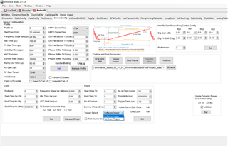

  • Hi Josh,
    Could you please give us some more references on how you are enabling the HW trigger in mmWave studio? Please see the below snapshot, in SensorConfig tab the Trigger select API should be Hardware Select.
    Ankit
  • Hi Ankit,
    Sorry for the late response. I just saw your update.
    At the moment, I have a DCA1000 board and a IWR6843AOPEVM board, and my computer has the mmWaveStudio installed.
    Please help me get me started.
    If I connect the DCA1000 and the AOPEVM and then connect the DCA1000 to the computer, will the above screen show up?
    Is there any reference manual on setting this up?
    Josh Huai
  • Hi Josh,
    If you open the mmWave studio you should be able to see the screen above. You should be able to find all the documents in the below location in docs folder.
    C:\.......\mmwave_studio_02_01_01_00\docs
    Ankit
