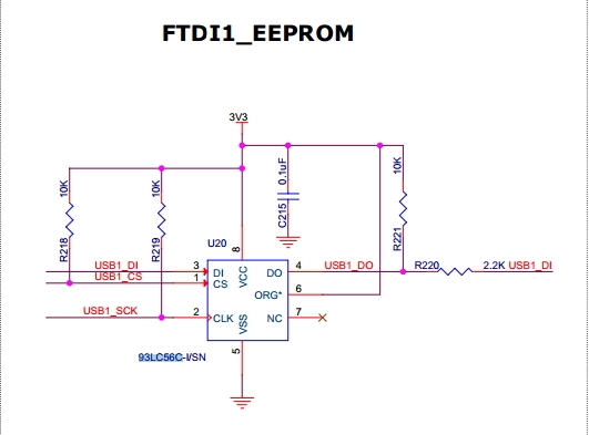

Hi SIr
Due to design requirement, we add one FT4232 in our debug board in order to use mmwave studio.
in the schematic , FT4232 has one external EEPROM (same with DCA1000 schematic). Dose TI have the firmware to program it or any other document about the internal data for programming.
thanks in advance.
BR
Yimin

    Hello Yimin,
    Its not a firmware but what you need is a FTDI template to be loaded onto the EEPROM. Attached is the EEPROM template you can use if you follow the exact same pin definition of the FTDI chip as used in the DCA1000.
    Vivek
