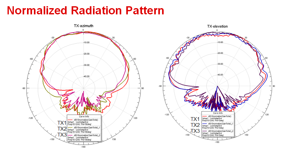

    Q: What is the antenna pattern for IWR6843AoPEVM?
    A: Rx Pattern:
    Tx Pattern:

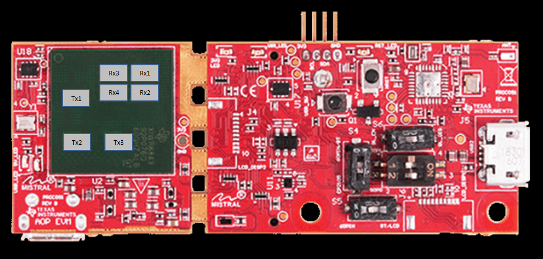

    Q: What is the arrangement of Transmitters and Receivers on IWR6843AOPEVM?
    Below diagram has the antenna placement and positions of virtual Antenna pairs.

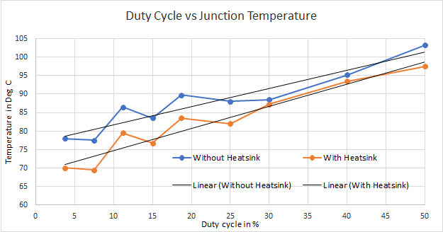

    Q: Is Heat Sink necessary for IWR6843AoPEVM?
    A: Heat sink is not a mandatory requirement for the EVM. However, EVM comes with the example heat sink option for the EVM, Heat sink helps in reducing the junction temperature. Below curve shows duty-cycle vs temperature in deg centigrade. There are four curves two of them shows temperature difference with and without heat sink options. Other two curves are best fit linear trend lines for the with and without heat sink options. Below graph is specific example of heat sink and customers could choose to design their own heat sink depending upon their application needs. Also customers could choose to operate different duty-cycle options depending upon the application requirements.care need to be taken not to exceed the junction temperature beyond 105 deg C.
    A: Heat sink is not a mandatory requirement for the EVM,however the EVM comes with the heat sink installed. Care needs to be taken not to exceed the junction temperature beyond 105 deg C when using the EVM. The heat sink helps in reducing the junction temperature,  customers could choose to operate different duty-cycle options depending upon the application requirements. More details on this can be found in the appnote linked below
    https://www.ti.com/lit/an/swra672/swra672.pdf
