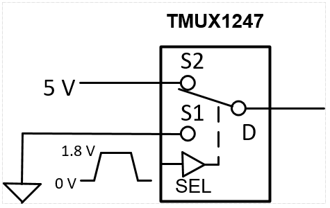

In remote radio unit applications, a switch can be used to control the input to a power amp stage for system level protection. Utilizing a device such as TMUX1247 allows a system to control when the DAC is connected to the power amplifier. The DAC output is utilized to bias the gate of the power amplifier with a 5V signal. The select pin of the switch can stop biasing the power amplifier by switching the gate to GND (0 V). The diagram below shows the TMUX1247 configured for control of the power amplifier.
Figure 1. Application diagram for input control of a power amplifier.
In cases with large parasitic inductances, the output of the switch may experience overshoot when switching from GND (0 V) to the DAC output voltage (5 V). There are several solutions that can be implemented to decrease or remove overshoot or ringing effects.
To replicate and measure the overshoot in TMUX1247, the test setup in Figure 2 was implemented. The supply voltage of the switch was 5 V. The output at the drain pin (D) was measured in the cases of switching from S1 (GND) to S2 (5 V) and switching from S2 to S1 using the select pin. The select high value was 1.8V and the select low value was 0V.

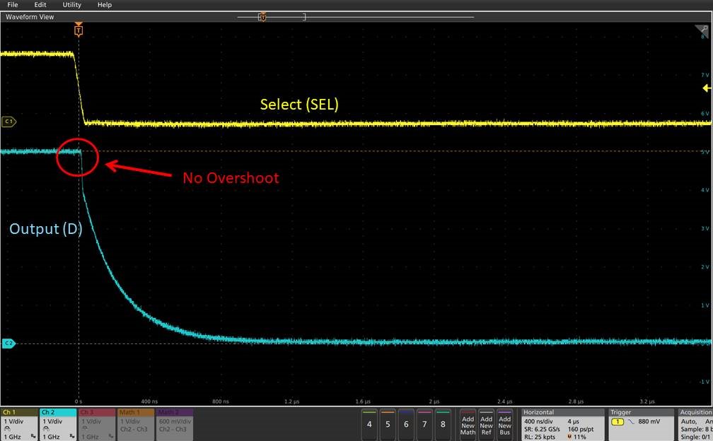

In addition, overshoot can be observed when toggling the select pin from high to low. The scope shot in Figure 4 shows the switching response of TMUX1247 as the select pin toggles from 1.8V to 0V. Note that overshoot also occurs on the falling edge of the output.
Figure 4. TMUX1247: Overshoot of falling output signal at drain pin.

Additionally, there is no overshoot observed at the output of TMUX1237 when the select pin is toggled from high to low.
Figure 6. TMUX1237: No overshoot of falling output signal at drain pin.
