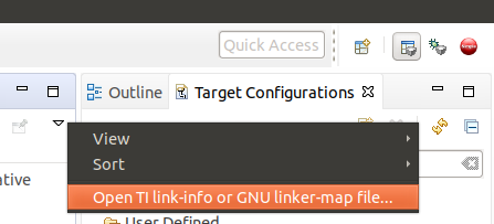

    Also, on the menu at the top right of the Memory Usage view you can use the "Open TI link-info or GNU linker-map file..." option to point at the map file to process:

    I'd like to point out that using this latter method (Open TI link-info or GNU linker-map file) I've had to explicitly go to that menu and reopen that map file after every build, else it didn't update by itself. I'm using CCSv9 (Version: 9.1.0.00010) on Linux. I am building a project that depends on NuttX, a RTOS, that uses its own Makefile and build system. With the symbolic link in place, the Memory Allocation view works correctly.
    I see that limitation as well. I have filed this issue so it can be addressed for a future release, the tracking ID is CCSIDE-3638.
