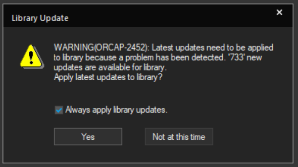

    Please do not manually import TI models. To ensure that all built-in libraries are up-to-date with the latest models, PSpice for TI will automatically check for updates or new models. A "Library Update" popup will notify you of any updates.
    Please select "Yes" to update. Selecting "Always apply library updates" is also recommended so you don't need to click "Yes" manually. If you select "Not at this time," you will not have the most up-to-date models. If you are still experiencing probe limitations with TI models, or cannot find the TI models within the tool, please make a post in the TI E2E. This may be an indication that we need to update or modify our model.
