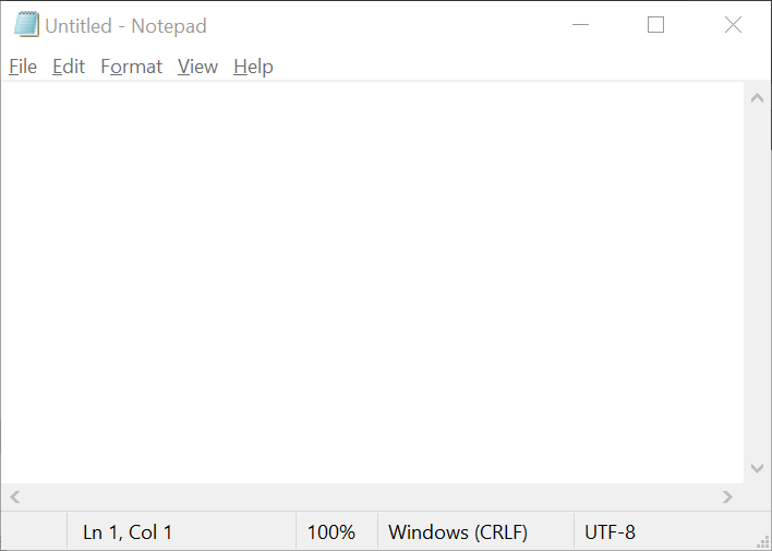

    There are many other tools that can convert files between those formats. One option is with just regular Microsoft Notepad. Open a new window ("File" → "New Window"), note that the information bar displays "Windows (CRLF)":
    Now, select everything in the original window (Ctrl-A) and copy that into the new window. Save the new file and edit your simulation profile to use the new file (or overwrite the old file without the need for changing simulation profile). That should resolve this problem.
