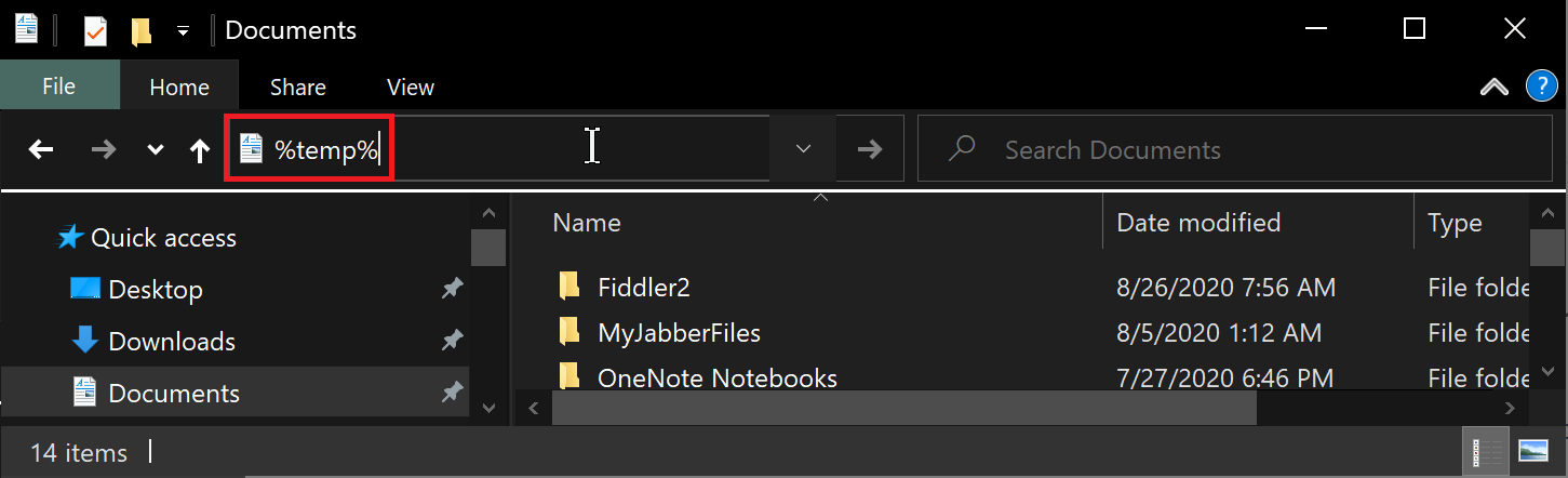

    1. Open a Windows Explorer window, type in "%temp%", then hit "Enter" to go to the Windows temp folder:

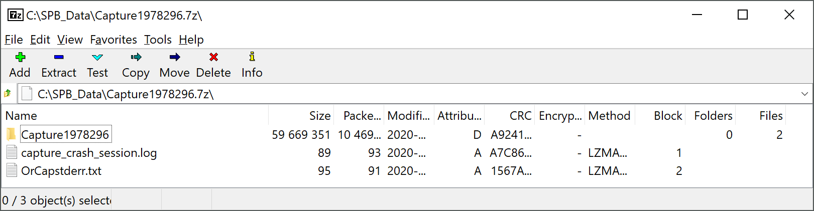

    2. Look for a newly created directory started with "Capture" followed by several digits, this is the memory dump:
    3. If there're session log and error files created at about the same time, they're helpful as well:
    4. Put all of these in a zip file and share it with us for troubleshooting.
