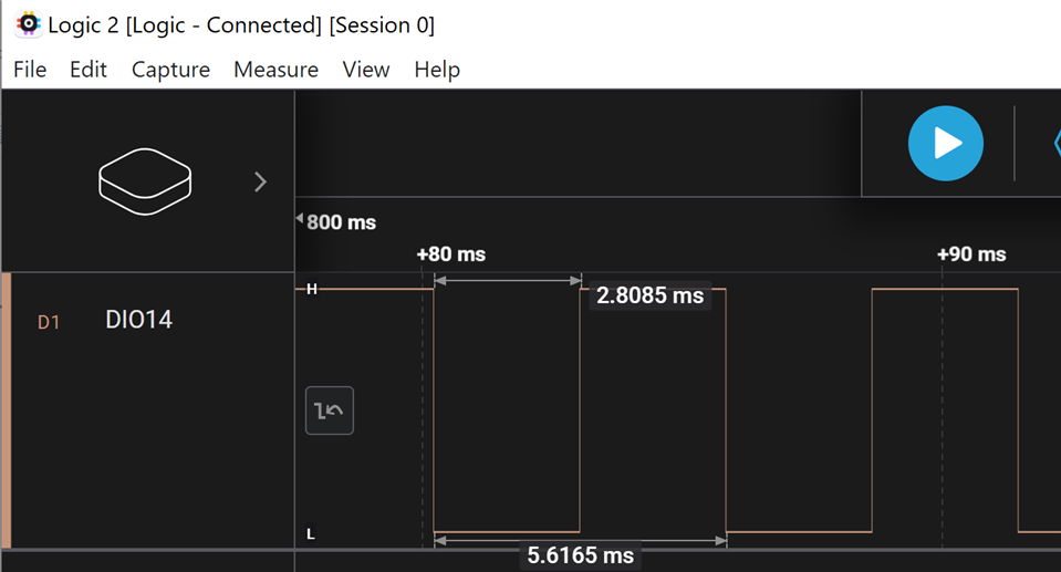

Can you specify what exactly doesn't work? Can you provide additional debug information and logic analyzer/oscilloscope screenshots of your external peripheral pins?
I modified the empty code to use usleep(1000); and got the following results
Granted, there is the delay ceiling to consider in the usleep function:
xDelay = (usec + TICK_PERIOD_USECS - 1) / TICK_PERIOD_USECS;
This becomes xDelay = (x + 1000 - 1) / 1000, and since the remainder of integer values are floored then values of 1000 or under will result in an xDelay of one. Thus usleep is not the most dependable for less than 1000 (1 ms) of sleep, although it does still provide a short 2.8 ms delay.
If this granularity is unacceptable then you can try the driverlib CPUdelay or DPL ClockP_usleep (shown in example below after adding the proper #include <ti/drivers/dpl/ClockP.h>).
