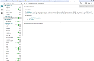

  • Include this as well,
    After Bootloader changes done in ccfg.c file, i am not able to enable Backdoor Bootloader option in the project -> project_zero.syscfg -> Device Configuration
    Kindly refer below screenshot...
    What steps are required to enable this?
    Rajnish
    For OAD-enabled projects, the CCFG should be configured from the MCUboot project.
    I hope this will help,
