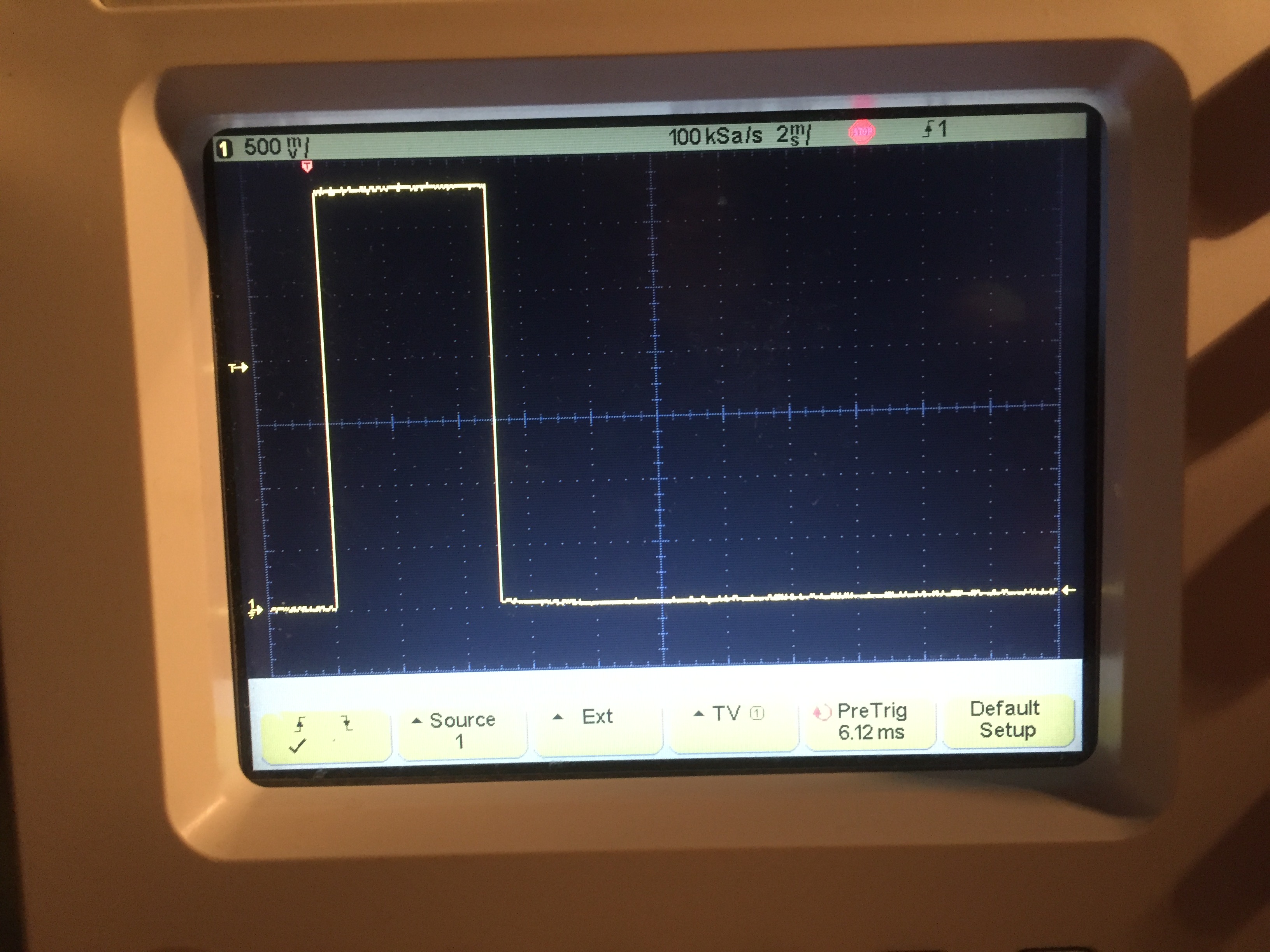

    thanks for your quick reply, however I think the timer is not reset by the SetLoadValue(SCB_Timer, 0) command. I have created a short program which demonstrates my problem by some Oscilloscope shots (see below).
    In this program I have implemented two timers (Timer1 and Timer2) and I use a digital output Board_DIO1 which show the timer result and which I added the scope shots.
    I initially start Timer1 and Timer2 at the same time, whereby Timer1 is loaded with a delay time of 8ms and Timer2 is loaded with a delay time of 5 ms. Both timers call an interrupt routine which creates a semaphore, the main program is waiting for this semaphore . After Timer2 has finished the 5ms delay the main program continues and stops the Timer1 which has not yet reached the match value. In the second step I want to create another 2ms delay with Timer1 (which was stopped before) and create another pulse of 2 ms . The desired result of the digital output is a pulse of 5ms closely followed by a 2ms delay and another 2 ms pulse. The Oscilloscope shot shows that there is a delay of roughly 350ms between the 1st and 2nd pulse which I only can explain that the timer value is not reset when loading the 2ms match value but still has the 5ms from the first run - as a matter of fact the timer completely counts up the 24 value which is 0xFFFFFF at 48MHz or 350ms and then reaches the match value of 2ms. I have also tried your proposal of setting a SetLoadValue(Timer1, 0) after the Timer_stop() but there was no different result.
    Reading the technical reference I also understand that the timer value is only reset to the load value for the count down mode - I do not find any remark in technical reference that in count up mode the timer value is modified and I also did not find any special command in the driver source code which gives an indication of timer value modification.
    My real program is a driver for a UART communication where I use Timer1 to read bytes out of the Uart FIFO, sample certain bits etc. (it is a quite extensive state machine). The Timer2 is in my application the interrupt of Uart frame errors in communication which need to trigger time critical synchronization.

    The first scpe shot shows the delay time of both pulses, the 2nd shot only shows the first pulse.
