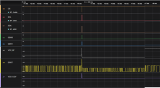

We have a question about the reset function of CC113L.

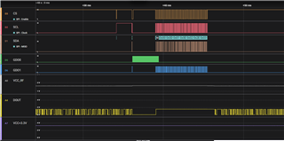

During ESD testing of our product, a symptom occurred that RF signals could not be received.
After checking the details, we found that immediately after ESD was applied, the VCC voltage dropped (from 3.3V to 1.7V), and as a result, the SO “H” potential also dropped, and the microcontroller could not receive the signal.
Will we know, what was the cause of this VCC voltage drop?
We know that CC113L has low ESD resistance, but is there a possible failure mode where the CC113L power supply overcurrent occurs due to ESD?If so, an overcurrent may have flowed through the protective resistor (R1=10Ω) on the main board, causing a voltage drop.
Also, this phenomenon is not recovered by SRES signal or strobe (CSn Low/High), but by turning VDD of CC113L OFF/ON. Is there any way to recover it by sending some command signal from the microcontroller?
We will send you the circuit diagram of the relevant part and the waveforms during ESD test.

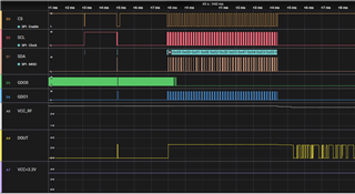

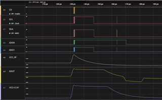

- Waveform when Down by ESD
Details of noise caused by ESD
Not recovered by RST command
It is recovered by VDD OFF/ON

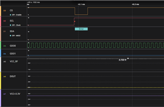

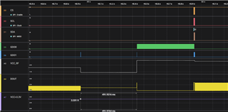

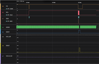

Sequence from RST to initialization of settings
Manual RST waveform
SRES waveform
Strobe (CSn_low-high) waveform
- Our circuit diagram

  • the VCC voltage dropped (from 3.3V to 1.7V)
    VCC is an externally supplied power supply. A power supply show not drop without an extra current draw. Did you check the system current consumption and the impedance to ground for all pins on CC113L to verify that the chip has not been damaged?
