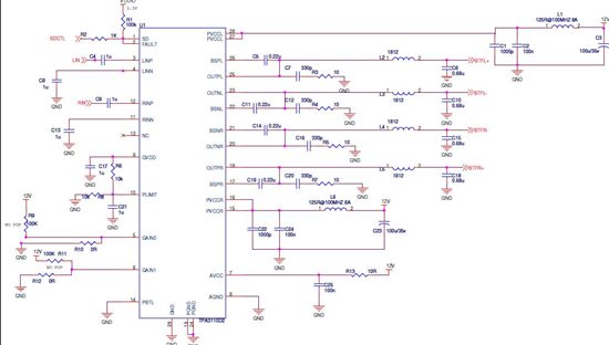

We have a TPA3110D2 amplifier board which is shutting down during the silence between the tracks or when there are any  in the music stream due to network congestion. This shut down problem also occurs when we hot plug the input jack. Sometimes without any reason within 4-5 seconds after power on. These issues do  not occur always but happening very frequently. Sometimes it plays fine without shutting down in all the above scenarios. The only way to bring it back is to disconnect and reconnect the power. As per the datasheet this seem to be DC offset problem but we have the input caps (1uf ceramic X7R) and also it plays absolutely fine sometimes. Any pointers on what to check for further?

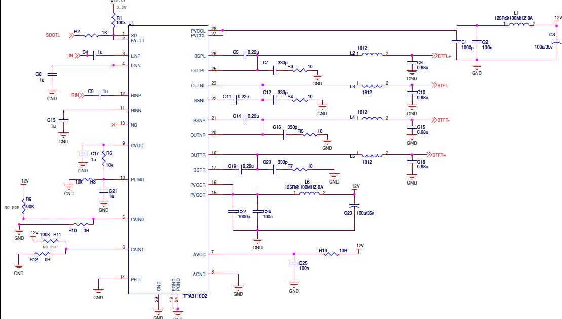

    Thanks. We are using single ended inputs. Cycling SD doesn't clear. Only disconnect-reconnect power will clear. Please take a look at the schematic. Gain is at minimum. So i/p impedance must be around 60K ohm. With i/p cap of 1uf 3db point is between 2-3Hz. Could that be a problem?

    Most likely not. Remember, you are looking for differences between LINP and LINN, for example. IF they both have 1 uF, and both have 60k impedance, even though it may take them a while to chrage up, they will charge up together, so the differential voltage across them is zero the entire time.
    You need to look and see what LIN and RIN are doing...
