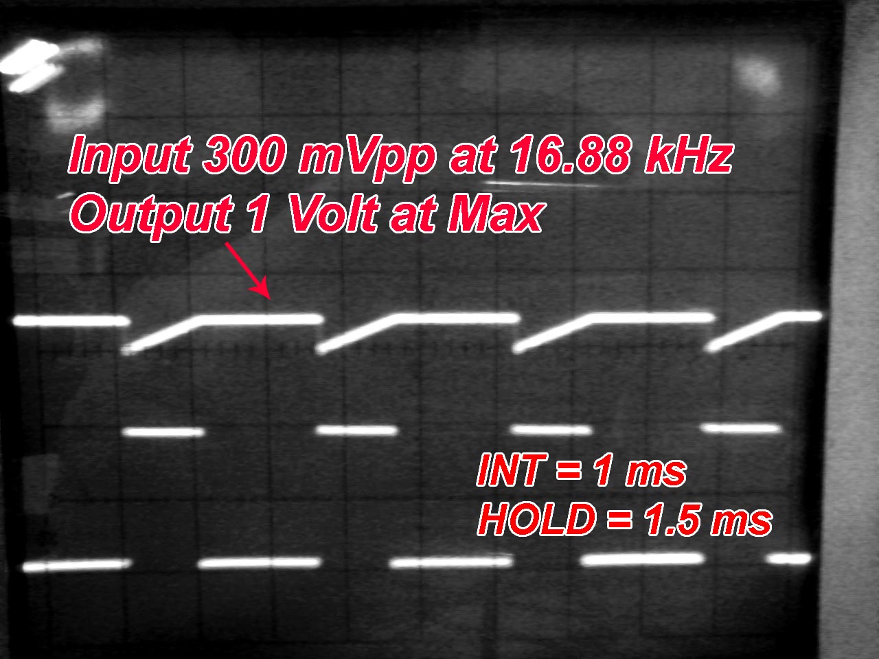

My name is Innocentio A. Loe, a newcomer to the forum.
I'm a student at Maranatha Christian University in Indonesia.
Currently, I'm working on a project which is using TPIC8101 as an engine knock detector.
I'm using MSP430G2553 for the microprocessor. The SPI transmission works just fine (I checked the SIMO and SCLK signals using oscilloscope).
I've tried to use the settings provided in the TPIC8101_Training PDF (7,3 kHz resonant frequency). I only change the INT/HOLD periods. At first I thought that my system works fine, since the output looks like this :
My problem is that the output signal doesn't change on those frequencies or other after I programmed the bandpass filter resonant frequency to e.g. 16 kHz (0x3F) or 1.22 kHz (0x00). I've also checked the output signal using ADC10 module, and found out that the max value (1024) is always at 7.3 kHz frequency, then goes down on lower or higher frequencies.
These are my SPI settings :
    //Data is captured on first SCLK edge, changed on the following edge
    //The inactive state is low
    //SPI Master mode
    //SPI Synchronous mode
    //MSB is transmitted first
These are the codes I've used to program the TPIC8101 :
    set_tpic(); //sets CS and INTHOLD pin low
    spi(0x42); //sets the prescaler - 5 MHz clock, SDO active
    reset_tpic(); //sets CS and INTHOLD pin high
    delay_ms(50);
    set_tpic();
    spi(0xE0); //selects channel 1 as input
    reset_tpic();
    delay_ms(100);
    set_tpic();
    spi(0x2A); //sets the resonant frequency - 7.27KHz
    reset_tpic();
    delay_ms(100);
    set_tpic();
    spi(0x22); //sets the internal gain - 0.381
    reset_tpic();
    delay_ms(100);
    set_tpic();
    spi(0xCA); //sets the integration time - 100 uS
    reset_tpic();
    delay_ms(100);
    while(1)
        int_hold(1000,1500);      //A function that that switches INT/HOLD pin states for a microsecond-based period
I would very much appreciate any help on this subject.

    Welcome to the forum! I think I see your mistake. In your code you write 0x22 to you gain (where the only valid range for gain settings is 0x80 through 0xBF). The band pass frequency setting uses all values from 0x00 to 0x3F.
    It looks like what you are doing is setting the resonant frequency with the first command below and by mistake setting the resonant frequency again with the next set of commands.
        set_tpic();
        reset_tpic();
        delay_ms(100);
    And then resetting it to:
        set_tpic();
        spi(0x22); //sets the internal gain - 0.381  // This actually sets the band pass again to 5.29 kHz
        reset_tpic();
        delay_ms(100);
    So when you change the top section you dont see a difference since it is immediatly changed to 0x22. Please take a look at the table below that shows the ranges of each setting in the device.
    I beleive to set the gain to 0.381 you should be writing 0xA2. Let me know if that does not work.

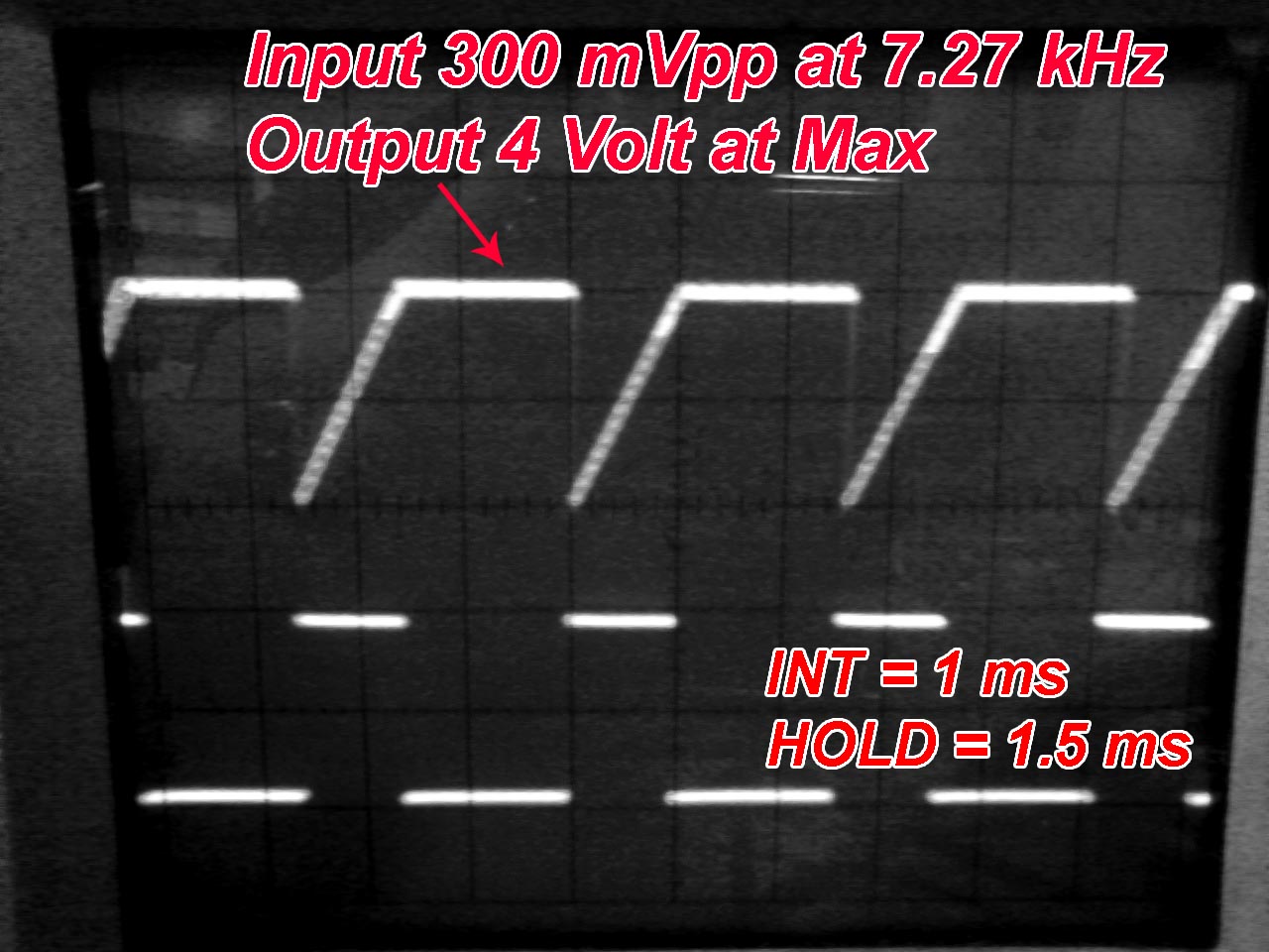

  • Thanks for the reply!
    I've seen now that that error comes because I read the TPIC Training file inaccurately. On page 26 it shows that the internal gain code is 34 in decimal, and 22h in hexadecimal, but I fail to see the binary SPI code beside it, which clearly ads 22h with 80h.
    I've tested it again using the right settings and know it's working properly. Thank you for solving this problem. I got to learn to read datasheets more carefully next time :)

    INT/HOLD pin is from controller.int/hold pin is low at the time of spi transmission and high later using timer  interrupt.This is working checked at that pin.
    i checked OUT pin of TPIC,it is comming to high state only  in 400us and hold in it for remaining 3.6ms.but as per data sheet it should reach to high with total ON period and hold for off period.
    Please help me where could be the issue.

     3)I observe the OUT voltage always 4.8v whether sensor connected or left it as open
  • Well... Since it seems that your code has no problem, I would think that the fault is at the IC or perhaps the clock source. Since you haven't care to post any schematics then I couldn't help any further
