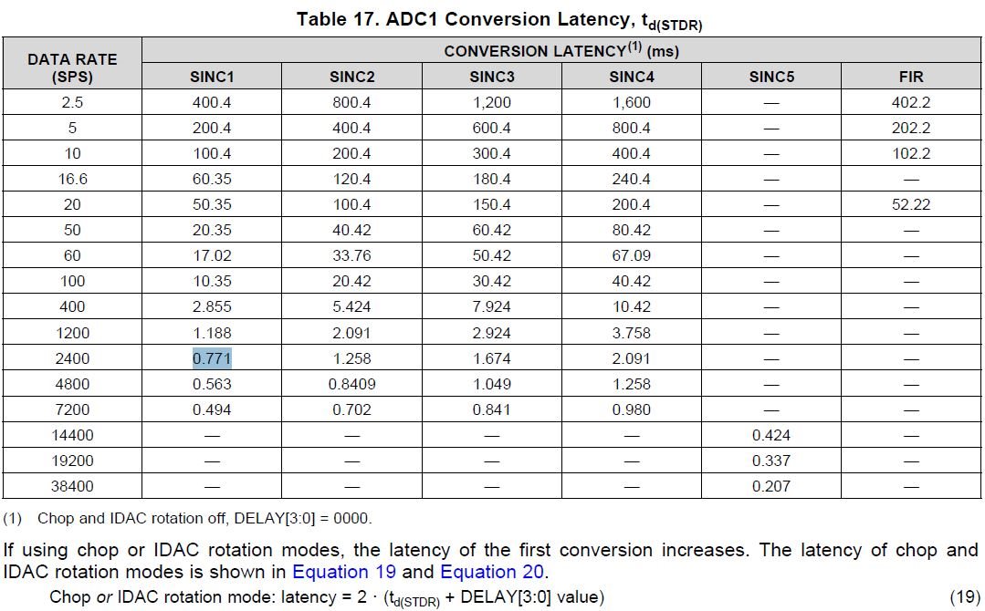

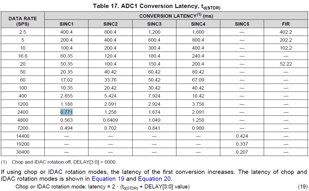

    While this works, the only issue is latency increases on each conversion (which makes sense because data isn't pipelined anymore I believe). I have a requirement to complete each adc capture from the moment of a start at <1ms, with fairly 'low' SPS.
    At 2400SPS + Chop + Sinc1 in this new configuration, I get a conversion rate of about 1.6ms. Without Chop, it's roughly .824ms.
    The minimum I can change the SPS to get to a <1ms conversion rate with Chopping is 14400SPS, which is unfortunately too high.
    It appears that I cannot use this part's chopping abilities with the set of requirements I have.
    - Pushpal
  • Hi Puspal,
    With the nominal 7.3728 MHz clock and no additional conversion start delay, you might be able use chopping down to 7200 SPS and still get data in just under 1 ms. Otherwise, you could consider increasing the clock frequency, which would allow you to create data rates between 2400 and 7200 SPS. If those options don't work in your application, then chopping will probably slow you down too much.
    Below are the minimum times from conversion start to /DRDY low (for the nominal clock and DELAY[3:0] = 000). With chopping you would need to double these times. However, you would also need to consider how often you poll /DRDY and add the polling period, plus the time it takes to clock out the data, (if that is part of your 1 ms requirement).
