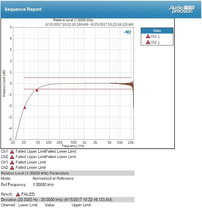

Hi team,
customer feedback that when they test the AIC3204 at 96Khz or 192Khz sample rate, they found the frequency response output in low frequency range is under -0.5dB, however the 48Khz will no have this problem.
Attached is their test report and test environment setup, please help to review it and advise if anything need to be considering. Thanks.

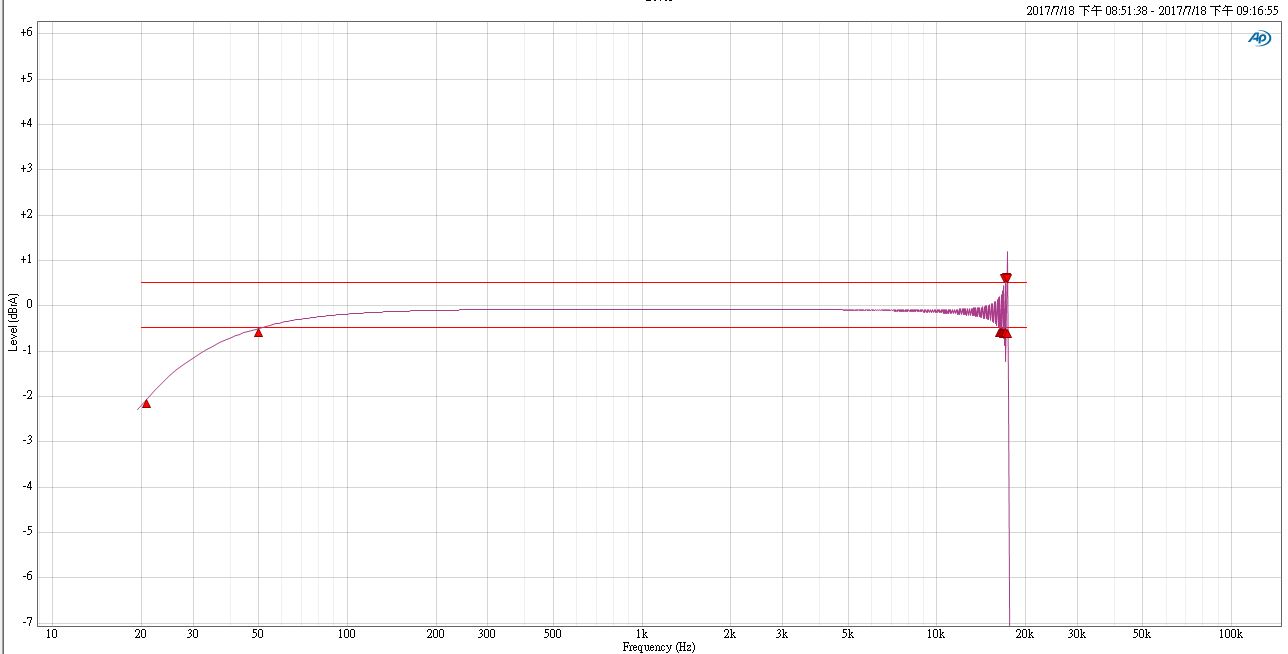

  • Hi Luis,
    attached is customer revised register setting, after customer revised the register 0x0E from 0x80 to 0x20, the test result is shown as below plot.
    it looked the low frequency is not improved, but the high frequency is got worse.
    Please help to have your comments if any. Thanks.
    Arthur

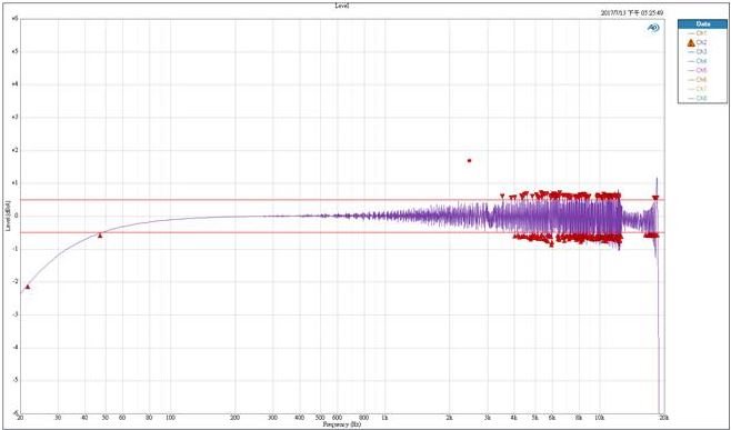

  • Dear Luis,
    We are the customer with this problem, it still fail on low frequency, we modified N/MDAC divider value with 192k sample rate. It still fail on low frequency and high frequency fail, the result show below.
    And it also did 1k ohm and 4.7uF low-pass filter with output, did you test this solution before? it become more and more fail before we ask you.
    Did you have any solution that test success of 96k or 192k, please tell us.
    Thanks.

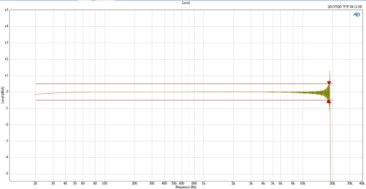

  • Hi Luis,
    We try PRB_P17 and PRB_P19 process, It useful on PRB_P17 at low frequency, see below
    but PRB_P19 same as PRB_P18 before we use, see below
    and we also test lot of filter combination of cap and resistance at output, it didn't work on high frequency response. Do you have registers config that can fix it? or hardware solution?
