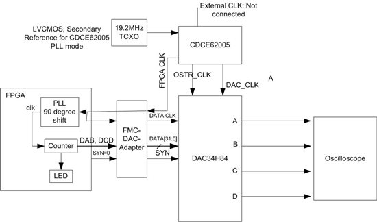

I encountered some problems when testing the dac34h84evm. The DAC board is connected with the Xilinx VC-707 FPGA board using the FMC-DAC-adapter.
The clock for data (DCLK) is from the CDCE62005 whose frequency is 19.2 MHZ, the same as DAC's input clock (DAC_CLK). Data is center-aligned. We use the software(DAC348x EVM Software GUI (Rev. B) ) to configure it. Only FIFO is enabled and x1 interpolation. But we don't get the analog output on the oscilloscope. Whatever data we input. i.e. DA=DA+1 or constant value, we get nothing but some pulses.
I checked the connection of FMC on FPGA to FMC-DAC adapter which is correct, so i don't think the input "DA" is wrong. So I don't know exactly what goes wrong. Please help. You can reach me at jamesfade_1234@hotmail.com or this reply. Thanks a lot.
I attach my VHDL interface code.

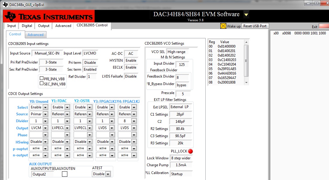

  • Kang,

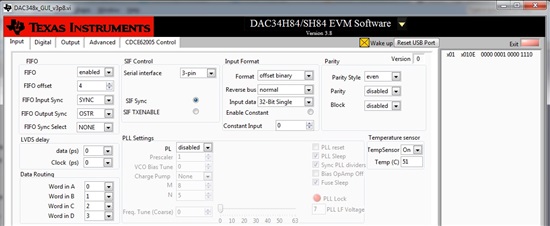

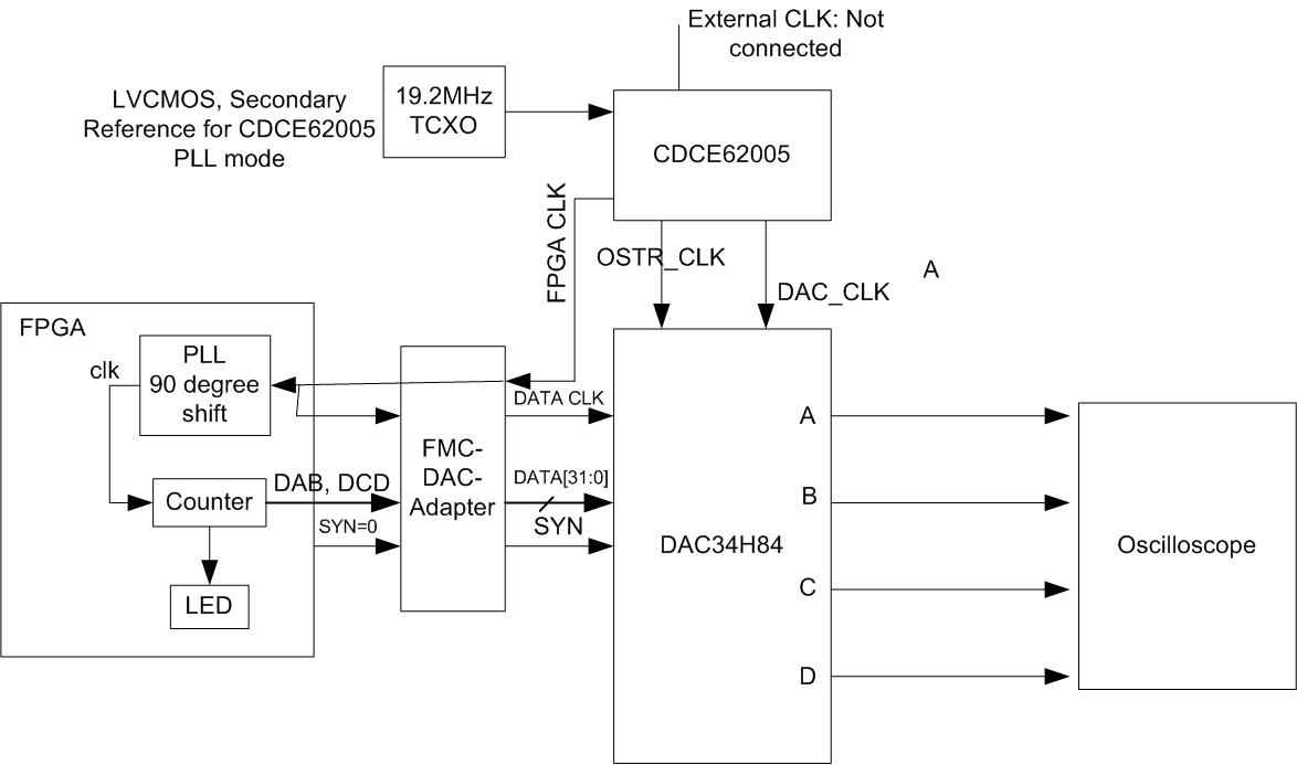

    Thanks for your reply. I'm stuck at this point still. Hope you can give me some instructions. I will explain my configuration in detail.
    Step 1. Set up the hardware as follows:
    Use TCXO 19.2MHz as input clock (configuration of CDCE62005 refers to Step 6). FPGA CLK is 19.2Mhz. PLL is used to shift clock 90 degrees to get center-aligned data. LED works correct. DATA_CLK is the same as FPGA_CLK. I use an oscilloscope to test the pin of DATA_CLK on FPGA which is 19.2MHz clock.
    Software configuration is as follows:
    Step 2. Input
    Step 3. Digital
    Step 4. Output
    Step 5. Advanced
    Step 6. CDCE62005
    As you mentioned, I do use differential signals for data, clock and sync with LVDS standard. Configure the CDCE for DAC_CLK in Step 6. In addition, I double checked the pin assignment of FMC on FPGA, and the Jumper connection on DAC34h84evm (mentioned in dac348xUG). Since our lab bought two dac34h84evm boards and adapters, I tried another set but it didn't work. Only pulses with correct periods.
    Hope you or related expertise can help me out. Thanks!
    James

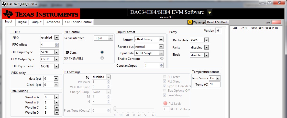

    After looking at the DAC GUI setup, I have the following suggestions:

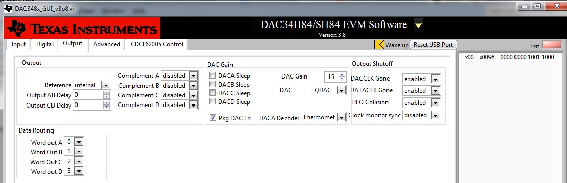

    1. The OSTR signal should be set to be /8 instead of /1. It is possible that the FIFO pointers are reset too often.
    2. On the output tab, under DAC gain, the package DAC en should be unchecked. It is use for the muxing of  the SYNC and ISTR signal internally to the chip. If you do not intend for the signal swap, please uncheck this.

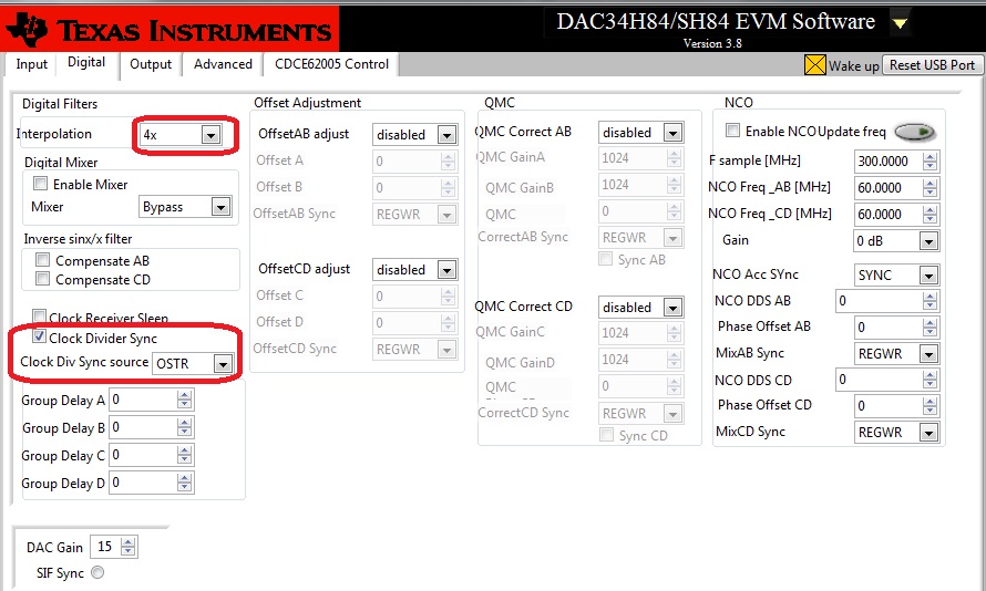

  • Hi Kang,
    Thanks for your kind reply. I spent a few more days testing DAC34SH84 and get the results as follows. Still hope you can help me out.
    (as you mentioned, I unchecked the "package DAC en" box.)

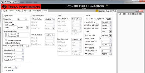

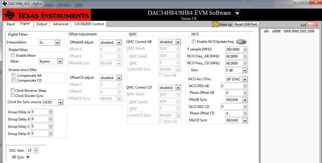

    Step 1. frequency setup
    DACCLK=737.28/4=184.32MHz; DATACLK=46.08MHz and so on
    Step 2. clock divider sync
    I don't know what "clock divider sync" means. Check this box, and I get the triangle outputs.

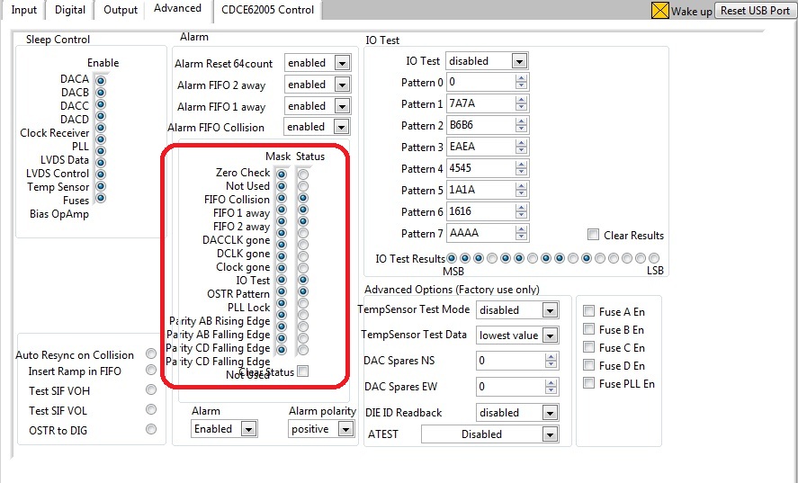

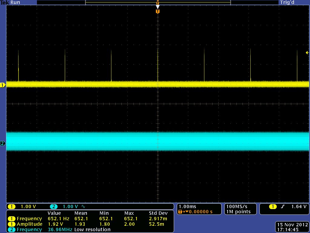

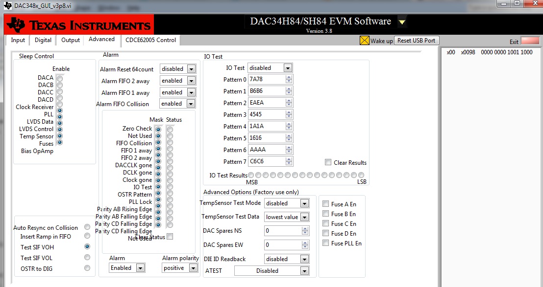

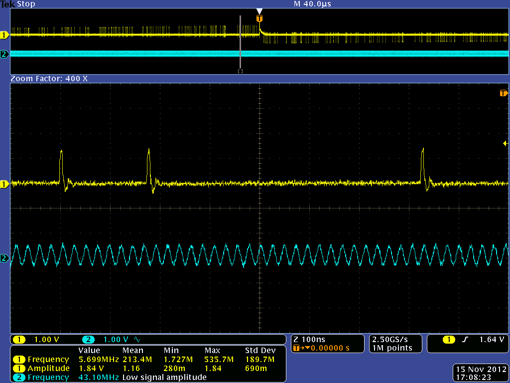

    Step3. Alarm
    Based on this configuration, I get the alarm as the above pic. The FIFO collision and  FIFO1away FIFO2away is set.

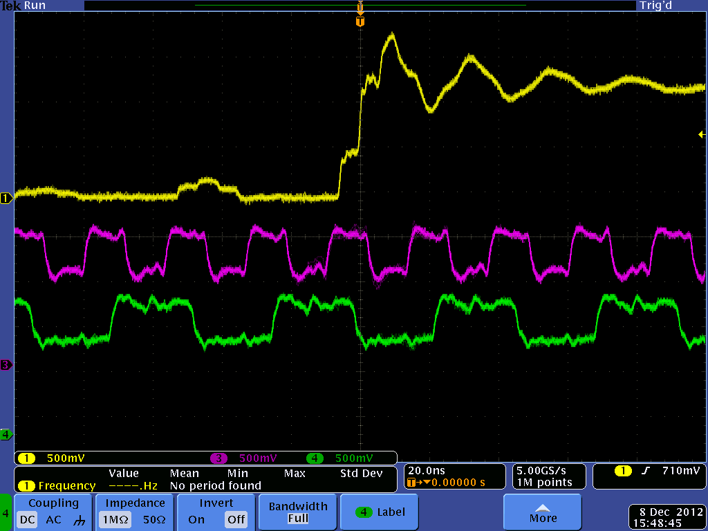

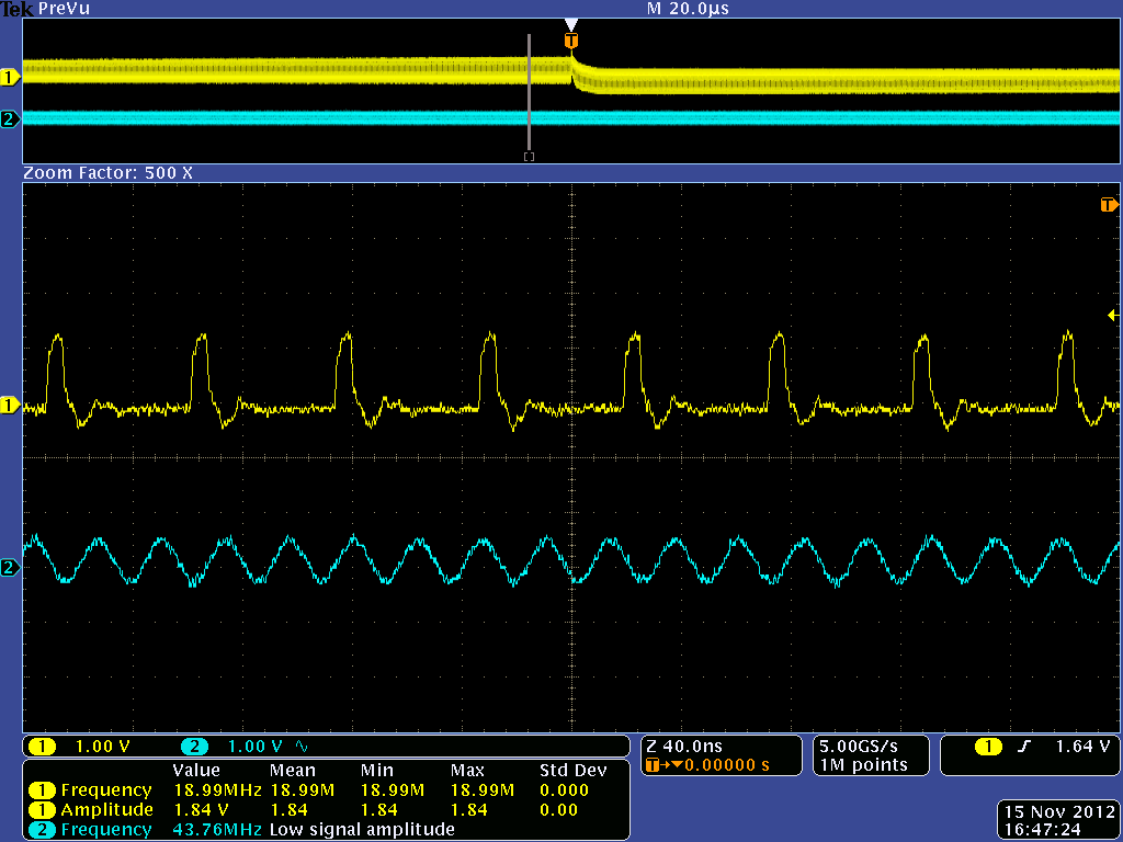

    Step 4. Oscilloscope output
    Based on the configuration, I get the result (yellow is channel output and blue one is the clock on FPGA)
    if I enable the OSTR output in Step1, which is set to 18 in divider blank, then i get the output as below:
    In the alarm option, the "FIFO collision" is always on.
    If I uncheck the "clock divider sync" box, or change its option to "frame", or change OSTR freq divider to 32 or larger (lower OSTR freq), I will get below :
    I double check the usage of PLL which is correct. And the latest VHDL codes is attached.

    I don't know what the "clock divider sync" means. Since in the DAC34sh84 datasheet, it mentions that in Single-Sync-Source mode "clock divider sync" should be disabled after initialization or synchronization. So in the Single-Sync-Source mode, i think FIFO pointer reset is unnecessary.

  • James,
    If you can send me the DAC34SH84 EVM configuration file along with the CDCE62005 setting, I can load the settings over here and test it with our TSW1400 pattern generator to see if the settings are correct. On the lower left hand corner of the GUI, you can click on "save regs" to save the settings. If the settings are correct, then you may need to check your VHDL code for error.
    To summarize, you are trying to configure the DAC34SH84 to run at 184.32MSPS, 4x interpoation with data rate of 46.08MSPS. Your LVDS SYNC should be a one time 0->1 transition at the start-up to synchronize the FIFO and clock divider.
    One quick thing that you can do to check for DAC operation is to enable the NCO with DAC constant input enabled. The following are the procedures:
    1. under Input tab, Input format section: click on "enable constant". Program constant input to be 0 for most negative full-scale.
    2. under digital tab, check "enable mixer". Make sure the coarse mixer is "bypassed". Under NCO, enable the NCO. For Fsample, type in 184.32MHz. For the NCO frequency, type in a generic frequency such as 10MHz.
    3. Press "Update freq"
    4. make sure NCO Acc SYNC and MixerXX Sync are set to "SIF_SYNC". This is one of a easier options to synchronize the NCO logic.
    5. toggle the SIF_SYNC radio button (near the lower left hand corner of the GUI in the digital tab). A 0->1 transition is needed to synchronize the NCO correctly.
    6. you should see a 10MHz sine wave at the DAC output. If not, there could be some setting problem at the DAC.
    Regarding the clock divider, it is an internal digital divider that divides down DACCLK to /2, /4, /8, etc for the internal FIR filters and mixer logics. It needs to be synchronized at start-up to ensure the divided-down clocks are phase aligned for optimal internal timing. You should enable the clock divider sync and set the sync source to "FRAME" so it will look for the SYNC pulse upon start-up.
    Regarding the alarms, please try to clear the alarms by pressing the "clear status" box to make sure it is not the alarms carried over from the start-up transients. Keep in mind that the alarms have "memory" effect and will not self-clear upon recovery to inform the user that there were errors prior. You would have to clear the alarms in order to check for new errors.

    Here is my configuration file.

    CDCE62005 Registers
    Freq:0.000000MHz
    Address	Data
    00		00400000
    01		81840321
    02		80120302
    03		C10C0303
    04		C1840304
    05		00101A85
    06		04BF1B36
    07		151877F7
    08		20001808

    2. I checked the DAC operation and I got the sine wave.
    3. I got the alarms in the pic by pressing the "clear status" box.

    Our FPGA engineer reviewed your VHDL code and have the following feedback:
    1. The data does not seem to have the 90degree phase shift with respect to the dataclock. On the GUI, you may want to use the LVDS Delay (under Input tab > LVDS delay > clock delay) to create the optimal setup/hold time for your data.
    2. The clock at which the ramp counters are running is the same as the dataclock. Since output interface is DDR but the ramp counters only on the positive edge, the same sample will show up twice on each channel. For instance, Channel A = 1,1,2,2,3,3,4,4,5,5 and so on.
  • Hi Kang,
    I checked my VHDL signals on DAC34H84EVM using an oscilloscope. The main signals are
    1. IO_DA[15:0] for the channel AB, every time IO_DA = IO_DA + 1;
    2. DATA_CLK
    3.  SYNC (0-1 one time transit)
    I grabbed the pic which shows the time of my signals as follows:
    Yellow line is the DAC output. Pink one is the DATA_CLK, and green line is the LSB data IO_DA[0], which is twice than DATA_CLK in frequency.
    I think the timing of the signals is correct. Do you think so?
    Based on the configuration you tested, I still couldn't get the triangle output.
    Could you send me your HDL codes via PM or email (jamesfade_1234@hotmail.com)? Thanks.
    -James
  • Hi James,
    You can check out our FPGA app note and Verilog file on the DAC3482:
    http://www.ti.com/analog/docs/litabsmultiplefilelist.tsp?literatureNumber=slaa545&docCategoryId=1&familyId=2023
    The timing of the LVDS interface looks pretty good. The DATA and DATACLK are center aligned. Using constant input and NCO method, we have also verified that the DAC is configured correctly.
    One thing I noticed is that the ramp will repeat every 65535 samples. With 46MSPS, the output frequency is a ramp with 700Hz. The DAC output is transformer coupled with the high pass cut-off corner of about 10MHz. I suspect the signal frequency is too low for the transformer bandwidth. Could you try to have the data increment by 16k? This effectively creates a Fdata/4 signal. Hopefully you will be able to see this signal at the output.
    -KH
  • Thank you, Kang! I've got the output by increasing the frequency of the ramp signal.
