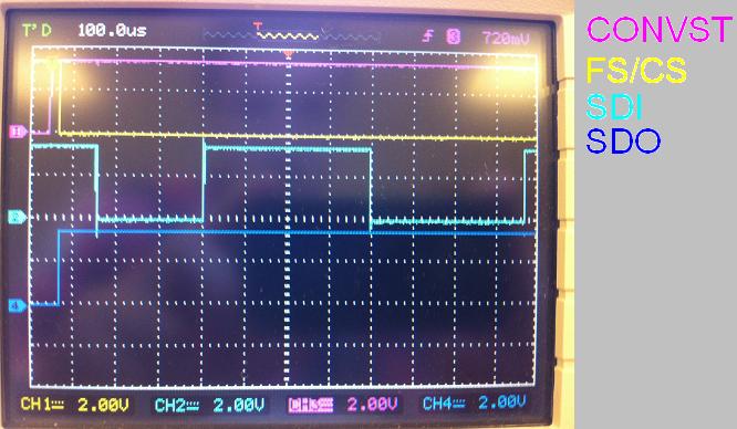

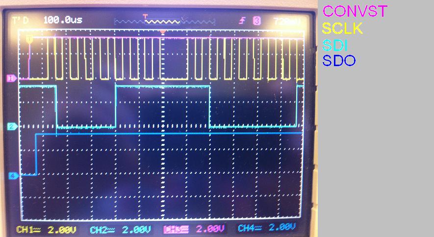

    as I was looking for information about how to get the digital ADC ADC8331 running I found this thread. I cannot establish a communication with a single chip and hope to find support here. I am not sure if I connected the chip wrong, or if I made an error when initiating the configuration register. I would start explaining how I connected the chip. The following list describes how I understood to connect the 24 pins:
    1) IN1: 1V DC test signal which cannot be observed on the SDO-channel
    2) IN2: NC
    3) IN3: NC
    4) NC
    5) NC
    6) NC
    7) NC
    8) Reset: NC
    9) EOC/INT/CDI: Not connected since I do not wish to evaluate this information. Is it correct that I do not use this pin? As I understood it the EOC-pin is only for evaluating whether or not the conversion is complete in the microcontroller.
    10) SCLK: Master clock from uPC
    11) FS/CS: Channel Select from uPC
    12) SDI: Master output from uPC
    13) SDO: Master input from uPC
    14) DGND: Connected to AGND
    15) CONVST: Connected to output from uPC
    16) VBD: Connected to VA = 3,5V
    17) VA: 3,5V
    18) REF+: Connected to VA = 3,5V
    19) Ref-: Connected to AGND
    20) AGND: Ground power supply
    21) ADCIN: Connected to MUSOUT
    22) MUXOUT: Connected to ADCIN
    23) COM: Connected to AGND
    24) IN4: Test signal AGND
    In the following I explain how I initiated the configuration register according to the data sheet on page 28. LSB first:
    0) System reset to '1' automatically
    1) TAG bit disabled
    2) Deep Power-Down disabled
    3) Nap Power-Down disabled
    4) Auto-Nap Power Down mode disabled
    5) Pin 10 is used as EOC/INT output
    6) Pin used as EOC
    7) EOC/INT active high
    8) 500kSPS
    9) Auto-Trigger: If I use this mode do I still need the CONVST-pin?
    10) Conversion clock (CCLK) = SCLK/2
    11) Auto channel select enabled
    I cannot send you pictures, but clock-channel, CS-channel, CONVST-channel and SDI-channel show what I expeted to see on them. The CONVST high signal arrives before the CS low signal. Then I observe the CFR bytes cycling through with each clock cycle. Still I cannot observe any communication on the SDO-channel even though different test signals are applied to channel 0-3. The SDO-channel goes high when the CS-channel goes low, if that helps narrowing down the error. I would be very grateful for any support and tipps you can give me in order to get the chip running.
    Jan
  • A small update concering the question above. I uploaded two pictures of the signals that can be observed when trying to communicate with the ADC8331. I loaded in this case a 0000b into the CMR. Since I configured the auto-trigger mode in the CFR do I have to upload a 1101b into the CMR for reading data, or maybe a 1111b for default mode? I hope the pictures help too. I gladly deliver more inforamtion if needed.
    Jan
