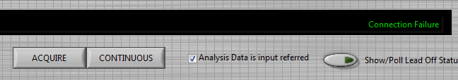

  • Zhaoting Du
    Posted by Zhaoting Du
    on Jul 22 2012 18:12 PM
    Prodigy160 points
    Hi Greg,
    Thanks for your reply. Did you mean ADS1298 software here ftp://ftp.ti.com/pub/data_acquisition/ECG_FE/ADS1298/ads1298ecg-fe-1.0.3.exe does not support Window 7? Now I have a problem about this software. It works well on my partner's laptop which has Windows 7 Home Premium installed and we did all our experiments with her laptop. However, there is an error when I installed and opened it on my laptop that has Windows 7 Professional.
    The error says 'An error occured with error code 8
    Write to Text File in ADS1298EVM_Main.vi<APPEND>
    C:\Program Files\ADS1298ECG-FE\libmmb0\saved\Estyx History.txt'
    I found the txt file mentioned above and open it, it says as follow:
    Read from /version    value 0.2.18    length 6    with an error code of 0 -> 09:42:39
    Read from /ads1298evm/conf/ch1set    value 0x1    length 3    with an error code of 0 -> 09:42:39
    Read from /ads1298evm/conf/ch2set    value 0x1    length 3    with an error code of 0 -> 09:42:39
    Read from /ads1298evm/conf/ch3set    value 0x1    length 3    with an error code of 0 -> 09:42:39
    Read from /ads1298evm/conf/ch4set    value 0x1    length 3    with an error code of 0 -> 09:42:39
    Read from /ads1298evm/conf/ch5set    value 0x1    length 3    with an error code of 0 -> 09:42:39
    Read from /ads1298evm/conf/ch6set    value 0x1    length 3    with an error code of 0 -> 09:42:39
    Read from /ads1298evm/conf/ch7set    value 0x1    length 3    with an error code of 0 -> 09:42:39
    Read from /ads1298evm/conf/ch8set    value 0x1    length 3    with an error code of 0 -> 09:42:39
    Read from /ads1298evm/conf/config1    value 0x86    length 4    with an error code of 0 -> 09:42:39
    Read from /ads1298evm/conf/config2    value 0x10    length 4    with an error code of 0 -> 09:42:39
    Read from /ads1298evm/conf/config3    value 0xDC    length 4    with an error code of 0 -> 09:42:39
    Read from /ads1298evm/conf/devid    value 0xB6    length 4    with an error code of 0 -> 09:42:39
    Read from /ads1298evm/conf/gpio    value 0x0    length 3    with an error code of 0 -> 09:42:39
    Read from /ads1298evm/conf/loff    value 0x3    length 3    with an error code of 0 -> 09:42:39
    Read from /ads1298evm/conf/loffflip    value 0x0    length 3    with an error code of 0 -> 09:42:39
    Read from /ads1298evm/conf/loffsensn    value 0x2    length 3    with an error code of 0 -> 09:42:39
    Read from /ads1298evm/conf/loffsensp    value 0xFF    length 4    with an error code of 0 -> 09:42:39
    Read from /ads1298evm/conf/loffstatn    value 0x6    length 3    with an error code of 0 -> 09:42:39
    Read from /ads1298evm/conf/loffstatp    value 0xFF    length 4    with an error code of 0 -> 09:42:39
    Read from /ads1298evm/conf/pace    value 0x0    length 3    with an error code of 0 -> 09:42:39
    Read from /ads1298evm/conf/resp    value 0x0    length 3    with an error code of 0 -> 09:42:39
    Read from /ads1298evm/conf/rldsensn    value 0x0    length 3    with an error code of 0 -> 09:42:39
    Read from /ads1298evm/conf/rldsensp    value 0x0    length 3    with an error code of 0 -> 09:42:39
    Read from /ads1298evm/conf/reset    value 0    length 1    with an error code of 0 -> 09:42:39
    Read from /ads1298evm/conf/sleep    value 0    length 1    with an error code of 0 -> 09:42:39
    Read from /ads1298evm/conf/config4    value 0x2    length 3    with an error code of 0 -> 09:42:39
    Read from /ads1298evm/conf/wct1    value 0xA    length 3    with an error code of 0 -> 09:42:39
    Read from /ads1298evm/conf/wct2    value 0xE3    length 4    with an error code of 0 -> 09:42:39
    When I tried to connect ADS1298 to PC, the board seemed not to be recognized by this software and I could not see the registers map in the software.
    I checked this error code in LabView error codes. Error code 8 could either mean a 'File permission error' or a 'DMA Hardware error detected'.
    Could you please help me fix this problem?

  • Greg Hupp
    Posted by Greg Hupp
    on Jul 23 2012 09:38 AM
    Genius9440 points
    Zhaoting -
    As noted, the ADS1298/1198/1298R/1198R software does not currently support any Win7 operating systems.  This is described both in the user guide and product folder page where you downloaded the software.
    We have had a couple customers tweak the software and successfully get it working on Win7, but theses are modifications done externally to our currently supported software.  So it is possible that for some reason that it works on your partners PC, but this is not the expected behavior of the software application.
    We are working to release a new version in the next few weeks that will support Win7.  At that time, we will change the user guide and product page to reflect this change.

    Hi Greg,
    I have a question about the source code here ftp://ftp.ti.com/pub/data_acquisition/ECG_FE/ADS1298/Source_LV_ADS1298.zip
    I tried to open the main vi 'ADS1298EVM_Main.vi' and run it. However, there is an error here says
    'An error occurred with error code 7
    C: \work\LabView Files\LV86\libmmb0\saved\Estyx History.txt'
    I have tried it both in LabView 2011 and LabView 8.6 and they all have the same error. Could you please tell me how I could run the vi in LabView environment?
