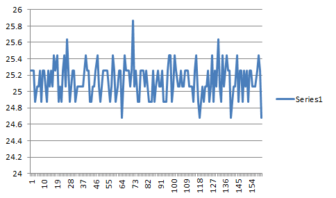

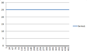

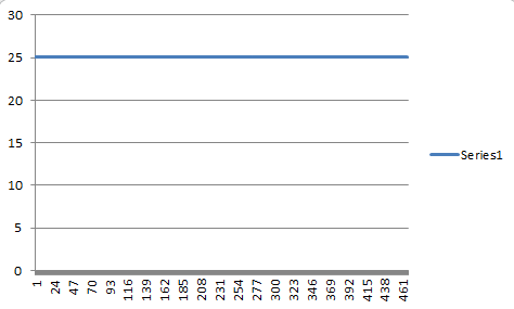

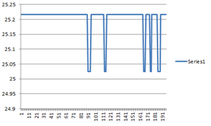

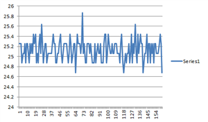

  • I attached result of lab test using ADS1118EVM.
    There is output difference between eash SPS options.
    <SPS860>
    <SPS32>
    <SPS8>
