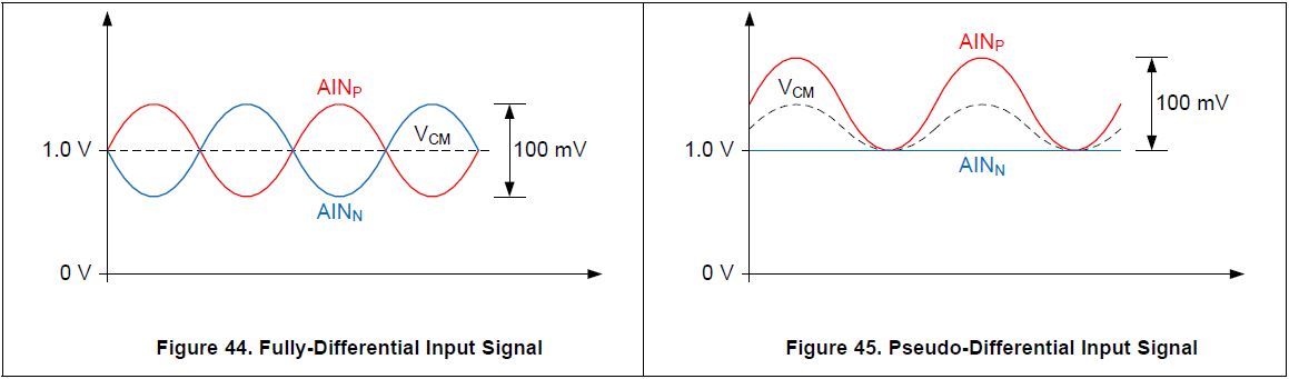

  • I have a question... the center of the data (vertically) is not fixed right? It depends on the signal amplitude right??
  • The common-mode voltage of the ADC differential output will always be (AINP+AINN)/2. If AINN is fixed, the common-mode voltage will change as AINP changes. We added some new figures to our ADS1220 datasheet that illustrate the difference between a fully-differential signal and a pseudo-differential signal. The latter is what you are essentially doing - AINN is fixed to a DC voltage above ground, while AINP is a moving AC signal. Notice how the common-mode voltage (Vcm) is changing:
    Saludos,
  • Oh... And this behavior is the same on the ADS1271 right?
    So... by having the signal centered on ~2.5 BUT with an amplitude <5, the center of the digitalized signal will vary.
    So I need to make sure my signal always be on the 0-5V scale right? OR calculate the average of the signal, giving me an approximation to the center each time...
    Am I right?
