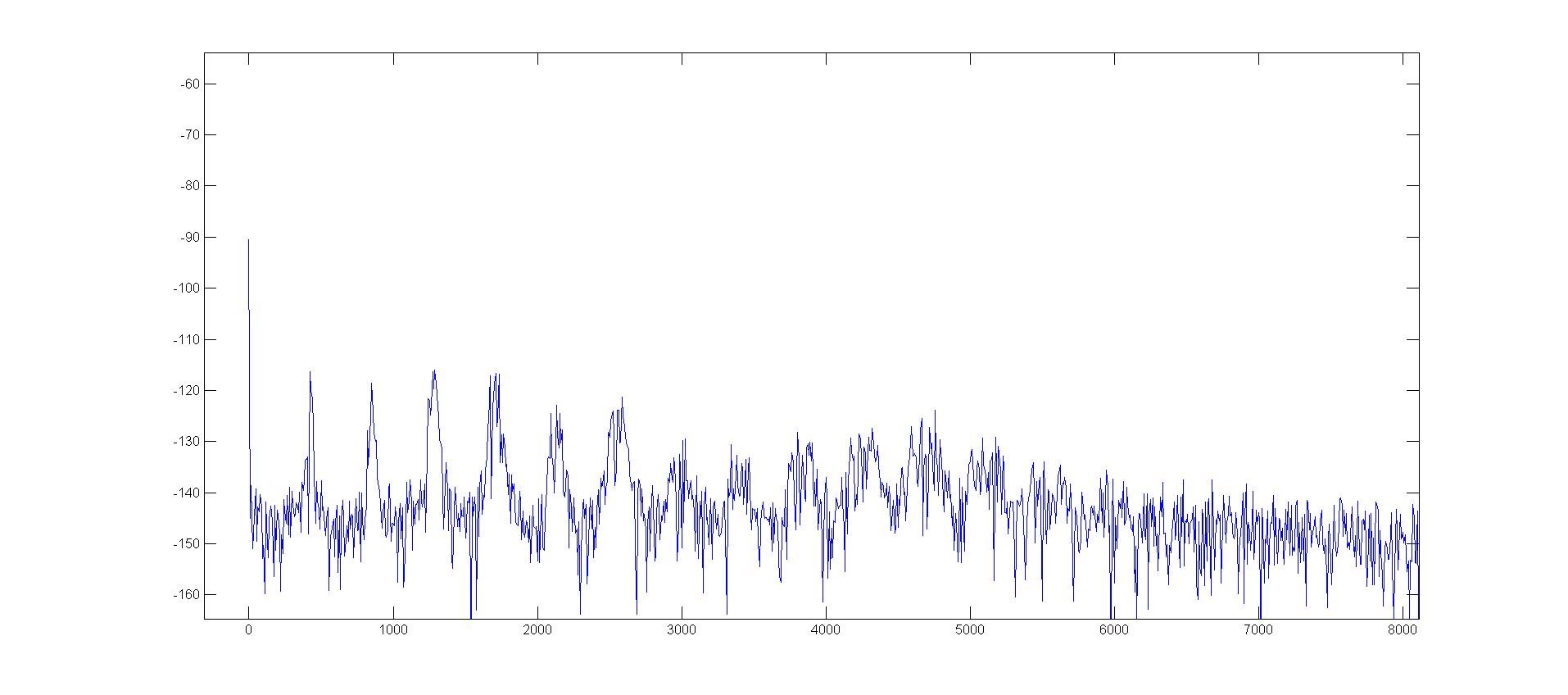

I observed some low frequency interference when testing ADS127L01EVM with shorted input.
The EVM is configured as default: OSR=32, filter is wide band 2, clk=16MHz, and is powered through USB. The differential input is shorted through J7-J9 and a short pieces of coaxial cable (~10cm).
Below is what I observed in GUI. You can find significant periodical spurs in time domain which results the ENOB (18.1) significantly lower than the datasheet result (18.84). What is the root cause of this periodical spurs?

  • Hi John,
    The low frequency interference is the result of clock intermodulation between 2 on-board 16MHz oscillators. The period of the interference in your capture appears to be approximately 400Hz, which is likely the difference in the oscillator frequencies due to tolerance. You could analyze the frequency spectrum to confirm.
    We are working to address this with a revised EVM in the coming weeks.
  • Ryan,
    Yes, it is around 421Hz.

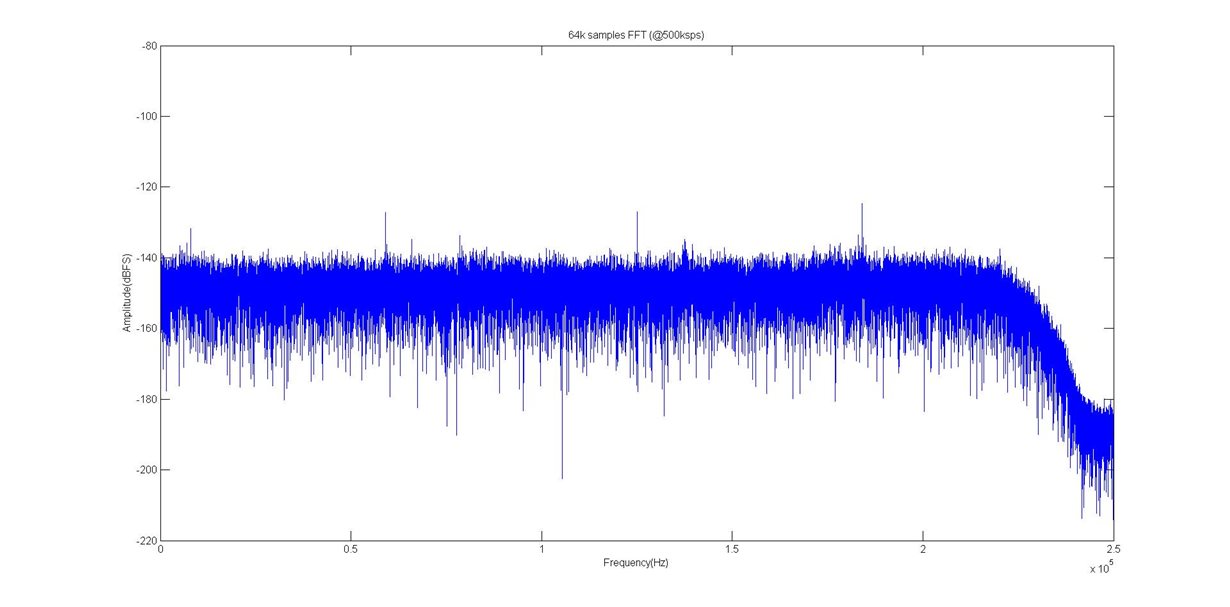

  • Hi Ryan,
    I tried your proposal, the low frequency interference disappear. The ENOB increased from 18.1 to 18.3 (@500ksps, WB filter 2, HR mode), still cannot achieve the data spec. I tried connect Y2 to Y1 through coaxial cable with shield grounded at two and signle side. The single side grounding is the best. Below is the FFT result:

  • Hi John,
    I'm glad this worked.
    The noise specs in the datasheet apply to DVDD = 1.8V. We see noise performance worsen slightly at higher digital supply levels, which is generally expected as the amplitudes of digital signals increase. Combined with an improved layout and clock distribution, the next EVM should get us closer to the device-level noise performance at 3.3V digital supply.
    If you have access to a dual-output function generator, you should be able to run the 'L01 off a 1.8-V clock while keeping the TIVA clock at 3.3V.
