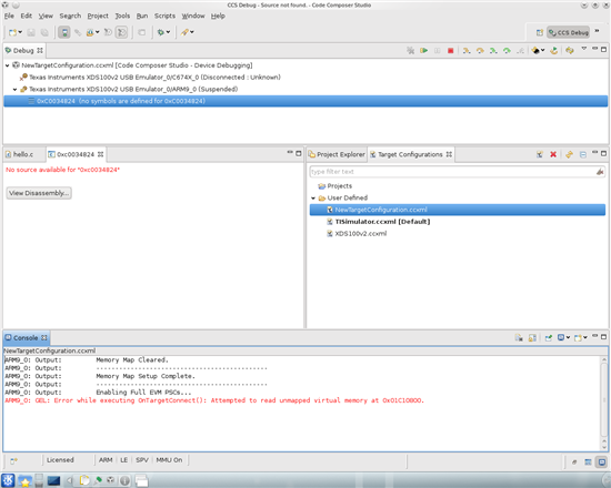

I am not able to connect to the ARM9  on the OMAP L138 using CCS 5.1. I am using the gel file that comes with MityDsp board (MityDSP-L138_ARM.gel). I get the following error when I try to connect. (snapshot1.png below)
ARM9_0: GEL: Error while executing OnTargetConnect(): Attempted to read unmapped virtual memory at 0x01C10800.

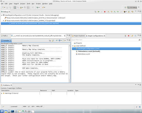

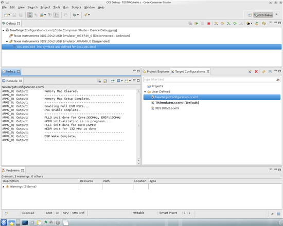

I noticed that if I stop the MityDsp boot at the Uboot prompt in the terminal. Then connect to ARM9 it seems to connect okay (snapshot3.png and snaphot4.png).  But I am not able to load the Hello world program (Basic Examples) on the ARM with the following error occurring (snapshot5.png above). As well the terminal hangs at the Uboot prompt.
ARM9_0: Loader: One or more sections of your program falls into a memory region that is not writable.  These regions will not actually be written to the target.  Check your linker configuration and/or memory map.
