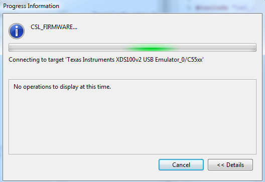

    I get that errors when connecting the device, also sometimes get no response when connecting the device(it lasts infinitely with no reply)
  • By the way, I didnt put eeprom on my board, I dont know whether it is required for connection.
    Now I get no response while connecting as shown in figure, infinite loop....
    please help!

    It was a connection problem. I forgot to give power to Vdd analog pin of dsp. It was left unconnected.     And I also upgraded to CCS 4.2 . Now it identifies the board.
