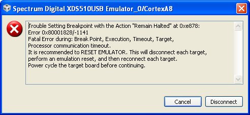

If I try to set a breakpoint in a worker thread that runs on the ARM I get this error immediately after the breakpoint is created:
How do I fix this?  I've been using CCS4 for months now to debug DSP side code and it has worked fine.  I have no GEL files in the configuration script.
