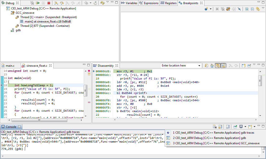

Hello I am running a variant of the VC3 demo on DM8168 using code composer 5.1.07001. I am trying to debug the demo and am having partial success. I can connect and step through code in general. If i simply connect using GDB in code composer and click 'Run' the processor will crash after a certain point in the program. There is no error information from either the command line or the console window. It simply stops responding and I have to powercycle. If i use GDB from the command line and tell it to run, it works fine. What does code composer do differently that command line GDB that couuld cause it crash?

    Assuming you are pointing to the exact same GDB from Eclipse and command-line and using the same parameters (are you using a .gdbinit command file?), the only thing I would suspect is a runtime constraint that causes the application to fail, as the underlying software is identical (GDB in both cases). Eclipse may execute things a bit slower than the command-line version, as the IDE does a lot of command passing and data transfers depending on which views are open (Expressions, Disassembly, Memory, etc.). Therefore I would close all views and see if the issue still happens.
    You can also check what is being exactly sent to and from the GDB server by looking at the GDB traces in the console window (check the attached screen). Maybe you can copy and paste the commands exactly to the command-line version and see where it is breaking the execution.
