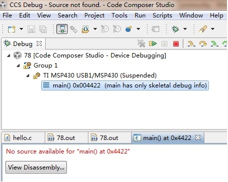

CCS v5.1 Build 'Release' for project MSPF5529's problem?

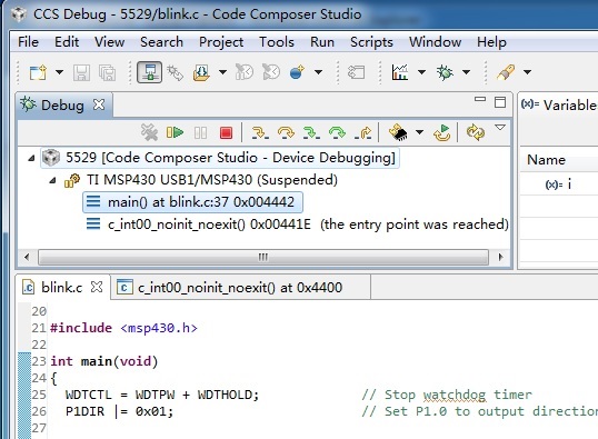

CCS V5.1 Build 'Relase'  for MSPF5529 Project appear "NO source available for......."?But Build 'Debug' for MSPF5529 Project is OK(AS shown)
  • Hello Daishi,
    does this occur with the debug configuration?  Do you have "Run to main" selected in the debug options?
    Please keep us informed.  This type of situation usually comes from either not running to main or ... depending on the configuration, lack of debug symbols which could be due to the release variant settings.
    Lisa
  • Hello Lisa:
           I have checked relevant settings debug configuration ,"Run to main" is already selected in the debug options.
          But "Relase" debug Msp4305529 project, still  Appear "source available for "main() at 0x4422"(main has only skeletal debug info)".
          In addition,  Compilation of data bytes are the same at the Running "Relase" and "Debug" Msp4305529 project  after.The original use CCSV4 not happen.

  • Hi Daishi,
    no this should not have anything to do with licensing.
    I am still not clear, does this happen in the debug configuration?  Do you see a .out file generated in both instances and have you tried loading that?

    Hi Lisa,
         DEBUG and RELEASE in two instances does have a *. out file  I have tried to download .  I also tried to the menu Run --> Load --> Load Program .
        Still happen " No source available for "main() at 0x4422" "?
    Daish Liu
  • Hi Daish,
    This is because in release mode the default is not to bother with the debug information/symbols but rather just build and load the program.  So I would suggest using release mode.

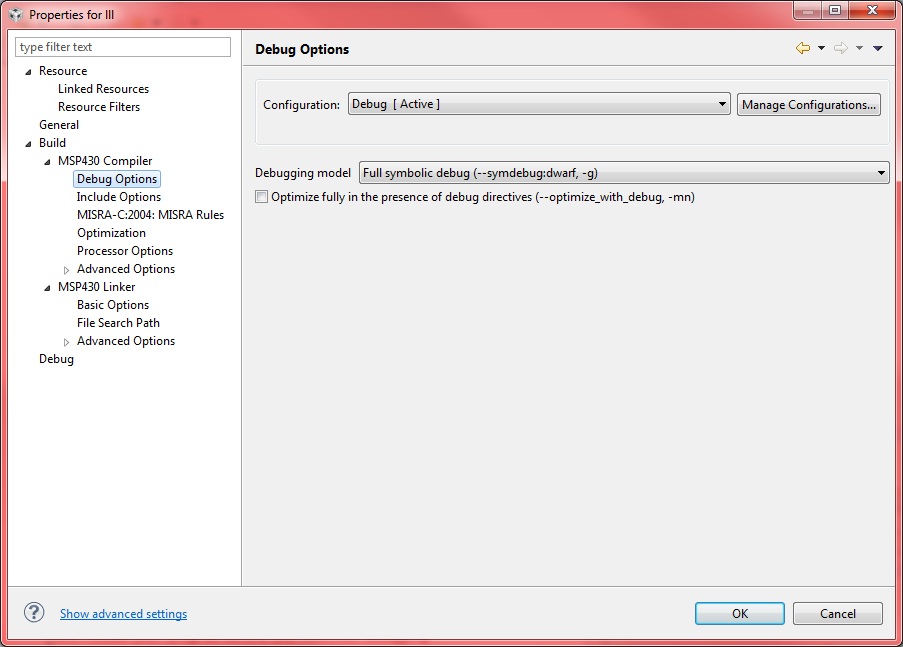

    If you want to get rid of that error and debug in release mode as well, please try setting the following option (screenshot below) and let us know if that helps.
    Project->Properties->Build->MSP430 Compiler->Debug Options .... and set the Debugging model to "Full symbolic debug".

  • Hi Lisa :
            Steps as you have described does not appear "No source available for" main () at 0x4422 "of the show, but there is a problem when I use Debug mode CCSv4 compiled Code Size is significantly larger than Relase mode compiled by the Code size is much greater , while under the Debug mode and with CCSV5 Relasem model compiled by the Code size is the same, why? because both Debug and Relase use this option to do the same? (Project-> Properties-> Build-> MSP430 Compiler-> Debug Options .... and set the Debugging model to "Full symbolic debug".)

  • Hi Daishi,
    ok, a couple comments to help close this off for you.  First of all, yes, when you do a full symbolic debug the debug symbols mean a larger file.   Note the symbols are only for debug which is why these are typically not selected for the release build.  The release configuration is usually used purely to generate the "final" optimized code and not for debugging.

  • Hi Lisa:
        The problem is when using CCSv4, REALSE mode Debug Options-> set the Debugging model to "Symbolic debug for program analysis (default)....." and After compilation, OK. But ,Using CCSV5, REALSE mode ,Debug Options set the same, happen " No source available for "main() at 0x4422" ?
     Why CCSV4 Relase model Debug Options -> set the Debugging model using the default settings, and CCSV5 not?
